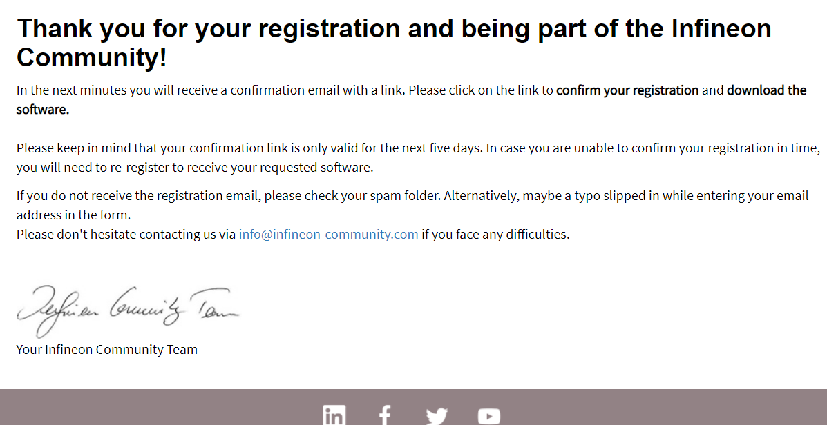

That Dave Software is Windows only, is behind a wall and force me to give my personal data and accept to receive their marketing communications :-(
Also I did follow their process a few times and I simple can not download it :-(
Can someone please share with me the download link as I simple can not download it??
Ok, 20 minutes later I got an e-mail with the Dave download link :-( -- so slow for current times :)
