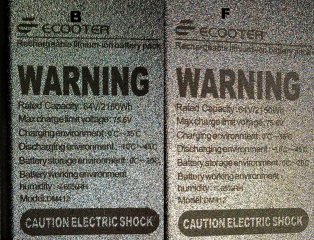

The elstimated weight of the batteries (lithium) about 25 kg each. The empty weight of the trike is about 100-120 kg (planned without the batteries). And it will be a 2 seater.
But If I am really limeted to 250 km range, then the fastcharging will be a kind of necessity.
I am curious what batteries you are planning to use, if you can build a 10kwh that weights 25kg?
My 5kwh batteries weight somewhere around 25kg with modern 21700 cells.
And why should it take 24 hours to charge? With 11kw (normal 16A 3 phase) it should be done in less than 2 hours.

Thank you for you guys. I have to contact the manufacturer and clean up the weight specification. Maybe consider another voltage if that working better...
So I contacted the manufacturer and unfortunately I was wrong and you guys right. The weight of the batteries near to 50 kg each. :(
50kg of batteries for a trike sounds quite alright, but I guess it won't exactly fit the definition of ultralight anymore.
