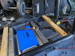

I bought my 52v 24ah over a year ago and finally getting to my build. Learned yesterday about UPP Battery and the triangle battery fires. My battery is a blue wrapped rectangle.
The info has me a little nervous. I’ve read only good things about the square UPP batteries, many with 3000km on them.
Any thoughts?
IMG_0600.jpeg I can’t even find another brand that makes a 52v 22-30ah battery that’s max 70mm thick that’s either rectangle or will fit I my location.

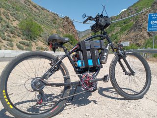

I have five different UPP 52 v rectangle batteries just like the one in your picture that are going on their fourth year. I also had a upp 52v triangle battery on a bike that built and sold. I maintain five different e-bikes for the family and have had no issues with UPP or BTE.
I recently put together a test rabbit 60AH setup (as a long range experimental unit) you'll notice the blue 52v on the bottom of the stack, (on semi-dense foam).
It is not supporting the entire as the top batteries are on a tiny bracket supported by top tube.
Bottom line I have no concerns about the quality and toughness and longevity of UPP
Wow, can you even pedal that? My knees would strongly disagree with that wide a block of nonsense where they need to be.
