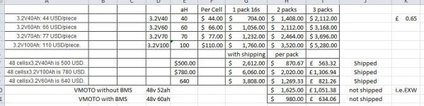

For now only 16s in installed for the mot, but will be having two fecther bms and a dcdc step up between the 10s to the 16s plus an ideal diode to protect the 10s from Nick Long of revolt.eu. That should be 5.6kWh. should be enough to get me 24miles to work.
