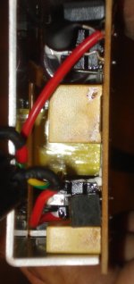

This charger/PSU from SoSauty died with no output from the 12V PSU. The charger appears to function when powered off my 12V lighting NiMH pack on CrazyBike2, though I haven't verified it's operation with batteries connected.
The first challenge was opening up the PSU case, because my special driver bits that would've fit these screws
were lost with my bike toolkit earlier this month. Had to dig around to find a flatblade driver bit that would fit inside the little triangular hole in the screws tight enough to drive them but deep enough to not slip; took nearly an hour of digging around because of my leg hampering me getting to a lot of stuff ATM.

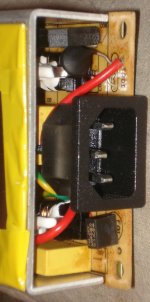

Immediately smelled cooked electronics once opened, most strongly down at the AC input end, particularly at the fuse. But neither fuse nor NTC are damaged or open.
Some internals pics:
Interesting that this PSU has two separate AC input sections, only one of which is populated at all. Not sure why it's made this way, as I didn't try tracing anything out to see if it's just maybe separate sections for higher current output, or two different input voltages, or what. Neither idea makes much sense to me, but all I could think of ATM.
One thing that looks dumb is that the main AC side cap is secured down so that it has nice solid heatsinking contact to a pair of higher-wattage resistors (taht presumalby get pretty warm, given their size), as well as the screw of the heatsink for one of the switching FETs, and some other components. Can't be good for the cap's lifespan, but since the charger is sealed with no ventilation it's probably moot anyway.
Only obvious problem I found visually is that there are solder blobs stuck to the PCB in various places, presumably from manufacturing. None appears to be in a position to short anything, but that doesn't mean there isn't one on the component side doing that. You can see a large one in teh screwhole here:
As a side note, they only used three wires in the output cable. Two of them are on the positive output, and one on the ground.
All same gauge wire, so dunno why--it's pointless to have the second positive since the return ground wire can't handle any more current than a single positive. The end connector that goes to the charger is wired two positive and two negative, according to the diagram on the label (pictured a bit above).
Continuity check across the output connector shows a dead short both ways, and ohm readings 10ohms one way and 23ohms the other. Something's shorted in the output stage, will have to unsolder the heatsinks to get under them to see more. Got bunches of other things to get done today, so this is all for the moment.
FWIW, I expect their stuff is identical to most of the other stuff like Hobbyking's, just with different stickers and paint jobs. Probably even from the same factory in China. :lol:
Anyhow, I expect that the failure of this PSU is heat-caused, and is probably the output FETs but I have to t/s more after I open it up further.
Normally I'd say there was a 115VAV input and a 230VAC input, but it's a universal-input supply. Weird.

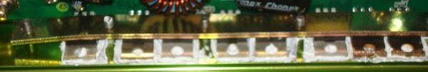

Some inside pics of the Venom charger itself, while I had it open to fix a problem I created: I was trying to figure out the menus, and it slipped out of my hand; I grabbed it before it hit the floor (not far a fall from the wheelchair anyway) but I somehow hit the first two buttons hard enough to crack the button stems off from the switches inside:
I'll have to glue them back on later, as I was too shaky-handed to do it by the time I got the screws off the end panel to slide it apart.
I also figured while I was in there I'd fix the alternate 12V (11V-18V) DC input, whcih is those two little clear-looking stubs of wire on the input (left) side. From what I could see, they were the bit left on there when the car-battery clips were cut off of it (but left in the box with it); I decided to reinstall them since I have some 31Ah 12V SLA I can use as an alternate power source while experimenting with this thing, until I can fix the 12V PSU that came with it.
You can see the pads for the 12V clips just under the black and white wires to the powerswitch, at the bottom fo this pic. I'd already desoldered the stubs of wire from the pads.
One bit of poor assembly I noted while in there is the FETs are plastered with a huge amount of thermal paste, and it is probably water-based as it is pretty much dried out already. If I end up using this to do any charging or discharging, I'm going to redo that paste completely.
A pic across the shunt resistors, under the LCD to show the rest of the component side of the PCB

Given that the PSU part appears to be no ventilation, and pretty small parts, I'm not surprised it fails at higher power levels, especially sustained ones. Plus having all the metal plating around it to reflect heat back into the electronics rather than let it out doesnt' help.
I expect the parts used are also run at their top end of specs, as so many things seem to be nowadays (really, for the last decade or two, whereas many things used to have some overhead room left above usage points).
I still have had no time to go back to this (or most other projects), but eventually I'd like to fix this. Once I do, you can apply the same fix to your more recent blown PSU, and it will likely take care of it, as I'd expect the same things to fail.
I got back to this tonight, because I wanted to use the Venom to charge some NiMH that's the wrong nubmer of cells for any of my regular NiMH chargers, but I dont' have a PSU to power the VEnom except for SLA (and I'd rather just use a PSU direct).
So I poked around and found two parallel .27ohm resistors taht read open, and have some of their coating blown off (presumably from evaporated wire-wound resistor material).
They appear to be current sense resistors or emitter(or source) resistors for the switching transistors on the primary side of the SMPS. Most likely the transistor are blown (shorted) but I haven't measured that yet. Can't seem to hold the soldering iron and sucker well enough to get them off the PCB without destroying some SMT resistors nearby, so maybe later when I'm nto so tired.
