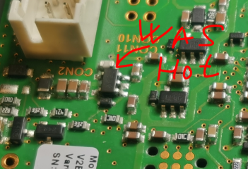

I had quite a few troubles with my Innotrace X1 controller and I posted about those here (the motor shaft destroyed the rotary encoder)
I repaired it but the problem went back a few months later. I repaired it again and installed it in the new Bafang m620 UART motor. I worked OK for one ride and next day I turned it ON the and display showed error 30 (no communication with controller)
I opened the motor case and found the FET driver was damaged. I also found some grease splashed from the new motor on the board so maybe this is what caused the damage.
I replaced the FET driver but the motor display still indicated Error 30. I noticed the 3.3V voltage regulator (AP2202K-3.3TRG1) on the board got really hot. I checked the board and found a shortage between 3.3V rail and the ground. I detached the 3.3V regulator and some capacitors in the 3.3V circuit thinking those are bad but the shortage was still present and the capacitors I unsoldered were good.
Then I unsoldered the STM32 MCU chip and the shortage on the board is gone. I checked the STM32 chip and it turned out the STM32 chip 3.3V pins and ground are shortened.

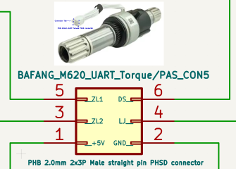

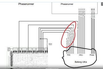

You use 4 wires from the torque sensor while the sensor has 6 wires. Other two wires have no functions or it is not necessary to use those to make it works?
I found Bafang ULTRA (M620) UART motor torque/cadence sensor wiring but I am not sure if it correlates with the sensor you illustrated
I also found pins marking for Bafang m620 original controller for torque/cadence sensor
5V and GND is obviously 5 volts (orange wire) and ground (black wire). But how the rest correlates with your torque sensor wiring (ZL1 (PAS, white wire), ZL2 (PAS phase shifted, purple wire), W (Torque, brown wire), DS (Speed/Direction, green wire)) ?
I feel like ZL1 (PAS, white wire) of Bafang m620 UART is Speed Signal Output1 (yellow) on you diagram (as I understand this is PAS signal). ZL2 (PAS phase shifted, purple wire) of Bafang m620 UART is Speed Signal Output2 (green) on you diagram (as I understand this is duplicated PAS signal just for reliability and safety and it is not necessary to use this duplicated signal since you can rely only on one PAS signal). W (Torque, brown wire) of Bafang m620 UART is Torque Signal Output (white) on your diagram (as I understand this is analogue signal (like throttle potentiometer) around 1V at zero pressure on the pedals and a little more at maximum pressure on the pedals). DS (Speed/Direction, green wire) of Bafang m620 UART is No Connect (blue) on your diagram (as I understand this is direction of the pedals rotation signal, Bafang controller uses this signal to immediately cancel assist when you pedaling backwards, which is not necessary feature so you do not use it).

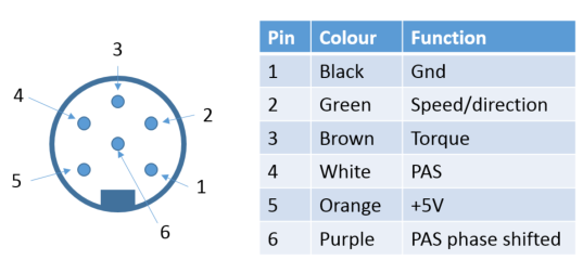

The Bafang sensor uses more wires than the ERider sensor. I've analyzed both in detail.
Both, ERider and Bafang provide a quadrature PAS signal for direction detection of the pedal movement. I don't use the second PAS signal, as there is no torque if you pedal backwards. So the output power calculated from torque*cadence*factor stays zero with no torque anyway.
The sixth wire of the Bafang sensor carries a somehow processed signal, but I couldn't investigate, what is done there internally.
Furthermore, a direction/speed signal is output. At crank standstill 0V at backward pedaling 4V and at forward pedaling an analog signal, which is not proportional to the cadence according to the first rough measurement :confused:. Why there is this signal is a mystery to me, the information is already contained in the other signals....

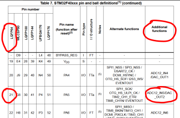

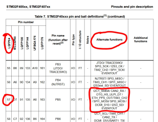

I have finished figuring out how Bafang m620 UART torque/PAS sensor is connected to STM32 MCU chip on Innotrace X1 VESC based controller. Does it make sense?
Does it make sense?
Hm, for a middrive it might make sense, as you need no cadence information, because the motor rpm is always in a constant ratio to the cadence. So the cadence is canceled out of the formula for calculating the motor power proportional to the riders effort. For a hub motor you would need the PAS-signals for getting the cadence to calculate the riders effort, as the ratio from cadence to motor rpm is not constant due to the gearshift.
