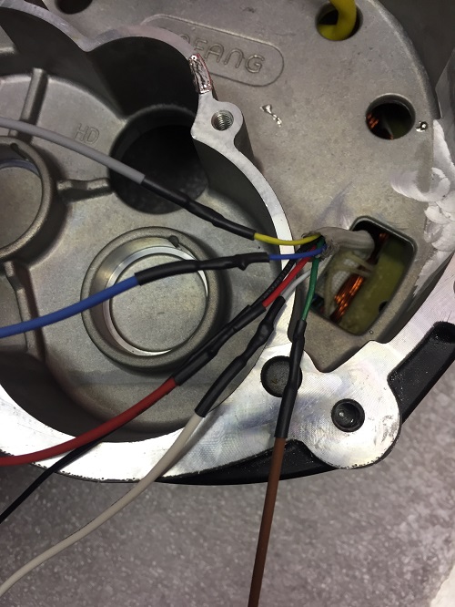

These connector have the same connections and almost the same color, only the last is white/blue
The other connector out of the bafang have 6 connections, the connector from the phaserunner 4

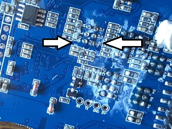

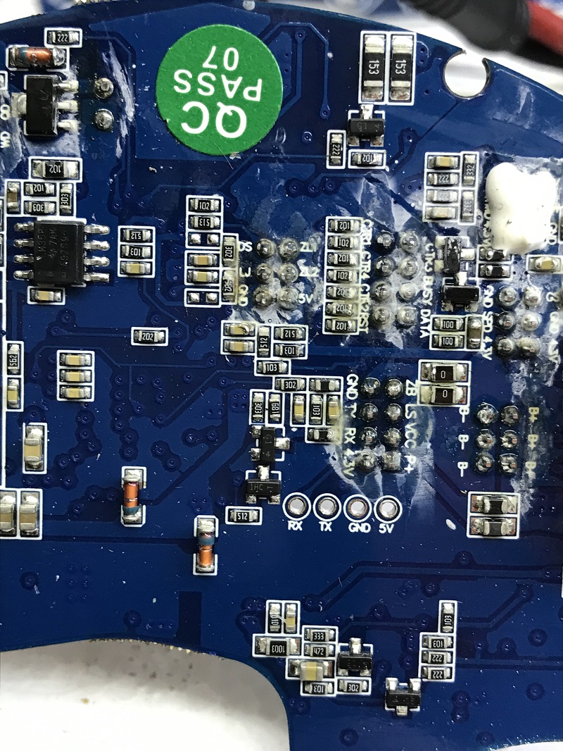

Removing the Bafang controllerboards, (bad work bafang already affected by acid)
Mine looked the same.
The white cable on the Ultra's Hall connector a is a 10K thermistor.
You can connect that to the CA3.

white to blue is ok?
I have ordered JST connectoren and tool.
Then I can connect the wires like on picture now.
And the other connector the Bafang white 6 wires (torque sensor I think) CA 4 wires

These connector is orginal not connected
Do I have to connect any of these connection, also the white cable, that come out of the motor, maybe torque sensor? The connector go to LJ connector on the controller
I hope this helps.

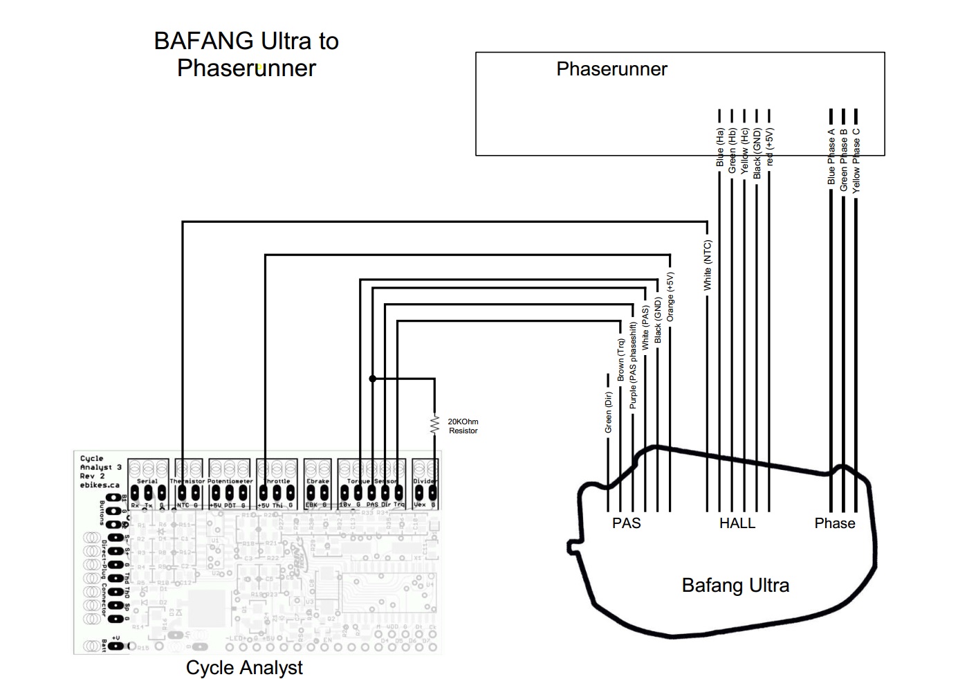

Phase
Phase wires go to Phase wires on Phaserunner
Hall
Hall Connector has 6 wires.
5V and Ground + 3 Hall sensors and a white cable that is a NTC thermistor that you can connect to the CA to monitor the temperature.
You can also decide to put another NTC yourself or even don't use a NTC at all.
PAS
Well this was the difficult one. It took some time before I figured this one out.
The Ultra's PAS needs 5V, you can steal 5V and ground from the CA or from the Phaserunner. (There is 5V and ground at the PR throttle connector.)
The CA didn't pick up the PAS signal from my Ultra. I had to add a 20K pull-down resistor between Pas signal and ground to make this work.
The Green Dir cable is not used
The Purple Pas Phaseshift is connected to the dir tab on the CA
Brown Torque goes to the Trq on the CA.
My Ultra had a Higo6 connector for the PAS with the right colours, which made it a bit easier.
This is a diagram I made:
Great thanks for the clear explanation en drawings
For the torque sensor cable from the Bafang have 6 wires, how to figure out which cables I need
mine cables are all white! :roll:

+5V and negative with voltmeter
+5V and GND is easy.
You can see it on the backside of the controller board.
I still have a picture of my plug that will make it easier.
orange | purple | white
black | brown | green
These colors correspond with :
+5V | Pasphase | PAS
Gnd | Torque | Speed/Dir
You can check with a multimeter
Between Gnd and PAS : gives you a pulse signal when rotating the crank FWD and REV 0V | 5V | 0V | 5V etc...
Between Gnd and PASphase : gives you a pulse signal when rotating the crank FWD and REV 0V | 5V | 0V | 5V etc...
Between Gnd and Speed/Dir : gives you a pulse signal (0V or 5V) when rotating the crank FWD and 5V constant when pedaling backwards
Between Gnd and Torque : gives around 1V and a bit more when you put torque on the pedals.
This is a video I made from PAS and Speed/Dir signal on a scope.
(Top signal is PAS, bottom is Speed/Dir)
