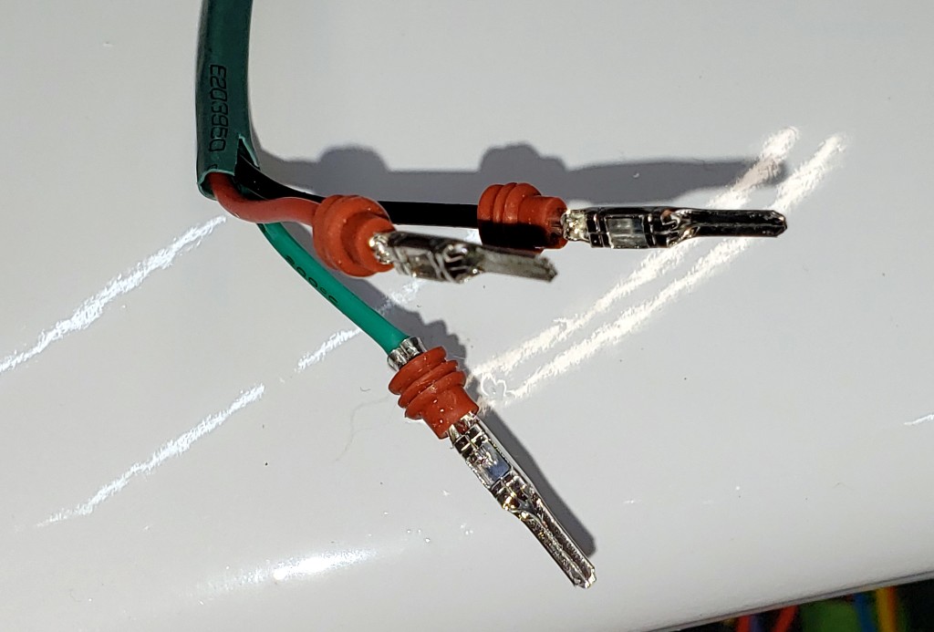

The engine electrics are done. Took a lot of time, but I am happy with the results. I also finished and covered the main harnesses towards the front,
Little pro tip if I may, because I didn't know it at first: the little red rubber thingies are to be crimped together with the metallic part.
This way water can't get in from the inner hole:
This video explains it well:
https://www.youtube.com/watch?v=OgrA_6zFqqY
No biggie, of course no need to rebuild the wiring just for that, just thought it might help you to know it on your next build (or to help anyone who reads this)!
