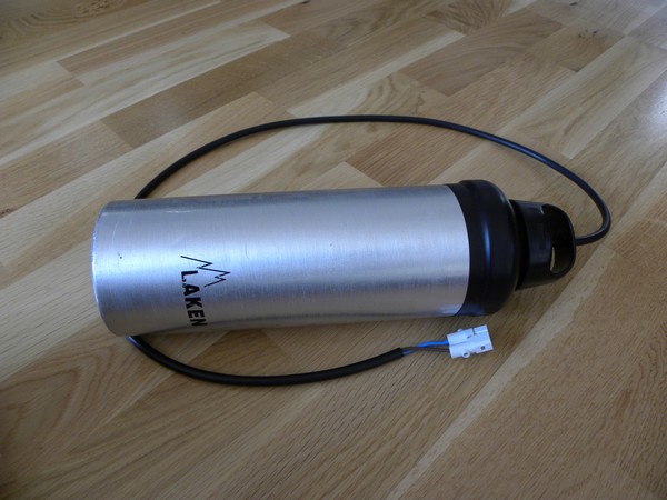

hi Raining,
I took just a normal water bottle (Laken 1,5L) and built a 36V 5Ah battery with konion cells.
You can see the building process here < http://www.pedelec-forum.de/forum/...nakku-ist-fertig&highlight=neuer+flaschenakku>
Cheers
Nader

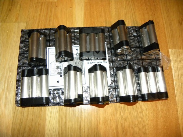

Selling stuff as cannot carry on with projects at the moment.
These are good cells, matched to IR (internal resistance) and can withstand 280A continuous with barely getting warm, this is a great addition to any 48volt based controller (usually they max out at 66volts) and gives the best boost for your original ebike.
I'm looking for an offer, (no silly offers please but something reasonable with postage by Royal Mail) feel free to offer an ammount they're assembled into a triangle shape for a 20" frame.
considering these have been used 30-40 charge cycles. (once a day for a month till 5304 motor burnt out).
Originally sourced from Dewalt packs purchased from Dewalt service center.
The cells gave a really good current, but recently when I tried using the pack, I accidentally forgot to charge one series of the batteries, so it seems there might be something wrong because the voltage only goes up to 52volts now. so I blew 4 cells. :(
