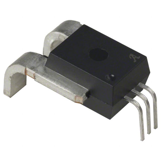

I decided to go with the Allegro hall current sensor. It's only about $5. They have many advantages, like being isolated, have a high output, and are pre-calibrated within a reasonable accuracy.

Good News!
http://digikey.com/scripts/DkSearch/dksus.dll?Detail&name=620-1112-ND
These new ones they have in stock are 60mV/A compared to the older ones with 40mV/A.(or the 20mV/A I got with the 100 Amp type)
So this is 50% more accurate than before! :)
Lastly... for those that might be thinking about Armature side limiting rather than Battery side here's a thought:
Take a current sensor and attach it to just one of the three brushless motor wires, then when you do the comparison with the comparator you just scale down the current by three.
So a 60 amp current limit (at the motor) means that you set up your circuit to read one of the wires and limit based on 20 amps. It should be no more difficult than brushed motor limiting...
Just divide by three. :wink:
Armature Current Limiting would also reduce the stresses on your drivetrain while at the same time reducing heat.
http://digikey.com/scripts/DkSearch/dksus.dll?Detail&name=620-1193-1-ND
This one also might work for me because I'm going to run at a maximum of about 30 amps. It has an exceptionally good performance rating:
133mV/A 8)
...and only $2.90.

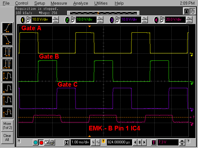

Safe, when using motor current limiting on a brushless motor, you have to deal with an AC signal on the current. The current in each motor phase will be reversed half the time. This is not a big problem, but has to be designed for.
Square Wave?
Is it an A/C wave or is it really a DC square (trapezoidal) wave?
Check out this website:
http://www.aerodesign.de/peter/2001/LRK350/SPEEDY-BL_eng.html
...so in these images it appears that the DC current is simply "chopped" in the same way that a PWM controller might work.
A brushless controllers current more closely resembles a PWM current than an A/C current. (if I'm correct on this) But the PWM is both chopped three ways for the motor and also can be chopped within the larger signal for each of the three. The chopping is much more complicated, but it's still PWM.
:?: What is the truth?

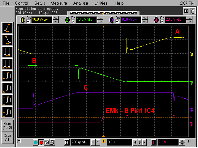

The actual motor wires see this:
The square waves sent to the MOSFETS translate into a lag time because the gates don't open immediately, but the idea is the same, that the power is DC and ALWAYS positive. But each wire gets just one third of the current in total.
The voltage is always positive with respect to battery negative, but the current in the phase wires will reverse half the time (measure it sometime).
The PWM introduces the same kind of problem in both brushed and brushless systems and needs to be filtered out of the current sensing circuit.
That makes no sense... :?
Maybe because of the inductance of the wires you might get some oscillations in the rate of current flow (in fact you have to see the current oscillate somewhat) but the current always will flow FORWARD.
It has to...
Otherwise you would have some current flowing backwards through the MOSFETS. (which might take place, but should be a small value) Where does this current flow "to" if it's going backwards? (keep in mind that all we are dealing with is a MOSFET that is either open or closed... the controller does not itself create an A/C current)
How do you know that current flows backwards?
The speed of these PWM pulses is very high, so I just don't know what gives you the "insider knowledge" about the current flow.
Do you have special measurement tools?
Are you somehow getting the Back EMF mixed into this reading?
Inductance can play some weird tricks (so I'm open to the idea that something bizarre is happening) but I'm not satisfied in understanding the idea of reverse current flow yet.
For one, I've actually measured it on a motor.
This isn't rocket science here. Each phase wire gets connected to either bat+ or bat- by the FETs at various parts of the cycle. When the phase wire is connected to the + side, the current will be going from the battery into the phase wire. When the phase wire is connected to the neg. side, current is going from the wire into the battery. The current reverses.

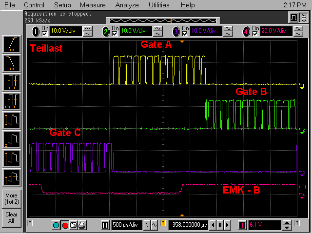

Safe, I think when this wire is connected to the battery's negative terminal through the mosfet, there's another phase linked to this given phase that's connected to the battery's + terminal. So the given phase that's connected to the batt's negative terminal is "sending current back" to the battery's negative, but there's a corresponding phase wire connected to the positive battery terminal that's drawing current from the battery's positive terminal. So the battery is always flowing from positive to negative, it's that a given phase wire alternates between the battery's + and - terminals.(And I believe it also is "disconnected" a third of the time, too. Or, rather, the circuit isn't closed even though it might be connected to one of the battery's terminals. I don't know about that, though.)
And, yes, there are bidirectional mosfets that'll conduct roughly equally well in both directions. I think the common place "N-type enhancement mode MOSfets" can do this.
