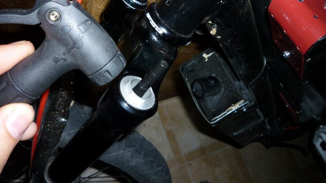

Also I was curious how ya'll set up your suspensions for road use? I have the PSI set to max, and rebound set to the lowest setting.
My roadbike has mechanical spring forks. But my setup is similar. fairly light rebound, but lots of spring preload which is like psi in an air fork. I like shocks to rebound fast enough for high speeds on pavement. Not too light though, or it gets like a pogo stick shock. I set more rebound on dirt bikes where you really do use all that stroke.
You need to tighten the spring or add air to compensate for the extra weight. With FS, both front and back need to balance. When right, if you bunny hop both front and rear would compress and rebound the same.
I half the air out of my fork. I was surprised how little was in it. All it took was two quick taps on the valve stem. This caused some problems when I braked really hard, the fork bottomed out and hit the controller box. Shit! I thought I gave it enough clearance!
Anyways the damn preload adjuster schrader valve is recessed so that a normal pump head won't fit in it! FUuuuuuuuuuuu Marzochi!Well I'm not the type of person to let a company force me into buying their unnecessary product. ($20 for a shock pump). Instead I bought a valve extender for $2. Works with my normal pump, but not my hand pump.
