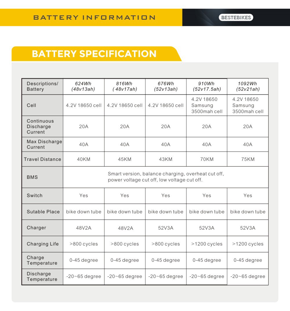

Complete newbie here. I want to buy a 52V 21Ah battery for my BBSHD motor. I have two separate questions:
1. what BMS should I pick 30A or 40A?
2. in the attached photo is the BMS value 20A or is it 40A? I don't know if BMS refers to continuous or max discharge.

BBSHD controller is rated at 30A. So you are saying I should go for a 40A BMS battery instead of 30 BMS? This would give the battery a little more longevity?
All of those battery options are rated 20A continuous, which means that those batteries aren’t enough to supply the BBSHD’s rated power. The cells of some variations probably are capable enough, but something else— cell interconnects, plugs, wire gauge, and/or BMS— isn’t adequate to sustain full power for BBSHD.
I have two newbie questions about this:
1. So that BMS value we see on seller's batteries is "continuous discharge current"? Batteries have their BMS rated as 30A and 40A and never knew what those values represent.
2. What would it happen if I used a 20A battery on BBSHD? Already paid for the battery and I have minimal chances for a refund.
21000mAH of 3500maH Samsung cells (likely the 35E) suggests 6battery cells in each parallel group. The 35E are 8Amp Continuous current rated cells so the cells themselves should have no issues providing 30A continuous.
You could ask the seller if they can upgrade to a 45A BMS which would provide more headroom.
Otherwise it will probably work but the BMS May be a little underpowered for the load and could get warm or cut out at extended load.

I understand. But for sure the 20A BMS would limit the power of the BBSHD motor, right? The speed and torque won't be as powerful as it would be with a 30A+ BMS battery, right?
The BMS **does not limit** current.
The amps spec is like for a switch or fuse, you must buy one able to easily handle what you will use.
If you go over you burn it.
Or maybe best case it just shuts everything down, aka current **protection**
Which is not **current limiting** that would be lots more expensive.
If the BMS has a current limit shutoff, then it would shutdown all power, completely disabling the bike, whenever you exceed the 20A limit.
If it does not have any current limit shutoff, then the 20A is the rating of the output FETs, so they would overheat whenever you exceed the 20A limit, and if you do it long enough, it would damage or destroy the FETs / BMS.
To limit the power of the motor, you must change the limit in the controller.
regan03 said:
What battery should I choose for my BBSHD motor? The motor runs at 30A.
It depends on what you want to happen, and what actual battery you have the BMS attached to.
If the BMS you choose has a 30A limit that actually shuts the BMS output off above 30A, then as long as the BBSHD does not draw more than 30A, the BMS and system will oeprate normall. But if the BBSHD does draw more than 30A, the whole system will shut off.
If the BMS does not have a limit that actually shuts the BMS output off above 30A, then it's just that the FETs are rated for 30A, and above that the heat they generate begins to be a potential problem. As long as the BBSHD never draws above that (or not for very long), it wont' be an issue...and the ssystem wont' shut down.
Similarly, a 40A BMS with a shutoff will rpobably never shut off the system, as the BBSHD is unlikely to ever draw that much.
A 40A BMS without a shutoff will probably never overheat it's output FETs either.
Now...the battery itself.
If you have cells that aren't designed for the 30A the BBSHD may draw, then they may overheat or be damaged, if the current draw is enough higher than what they are designed for.
So if you buy a pack with a 20A BMS and the cells are also desgined for that kind of maximum output, then the cells *and* the BMS would be stressed or even damaged if the BBSHD keeps drawing above that for long enough periods (how long? depends on the cells and the BMS and how well each are made, and how much current is actually drawn, and how well the pack is able to cool itself).
So if you've already bought a pack only able to handle 20A, then you will want to change the current limit in the BBSHD to match that; rather than changing the BMS to allow more current than the pack was designed for.
(especially since many sellers of packs don't even use "real" cells, meaning not the actual ones they say they are putting into them, so they may or may not really even be capable of what the pack was advertised as rated for, much less half again as much.
The pack may actually be capable of quite a lot more than they advertised it as, but unless it's tested at the higher currents, you won't know, and the test may be destructive. :(
So, it depends :cool:
