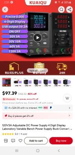

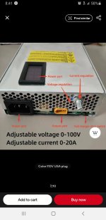

I am looking for a variable voltage charger that won't break the bank. I have packs ranging from 4s to 20s and dont want to have many individual chargers if possible. What are your thoughts on the chargers in the pics? Or do u have recommendations for one.

Regarding the ones in the images, I wouldn't particularly recommend any of them as they are somewhat pricey for what they are. Generally you want to look for something based off a nicer inverter/psu, preferably huawei, delta, and the like. I've got two of these, specifically the 120v25a version, and they work perfectly fine, do the ~3kws each without much issue. They are repurposed delta dpr 4850 dce which is a pretty solid rectifier and is pretty affordable.
