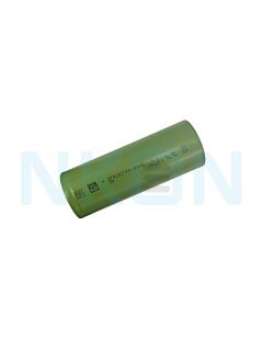

Messaged me with what seem ideal cells for their power output (70amp peak), energy density (57 to 35 milliwatts per gram compared to a123 26650), and size at 15amp hour and no cells in parallel necessary for me.
I think 75 amps peak. Enough.
A great price! New
You must be reading a different spec sheet to me ?
..the one in the link quotes a capacity of “1,500mAh” and rhe ability to support a 1C continuous discharge witha max pulse discharge of 3C, or 4,500 mA
Something screwed up there !..be very sure what you are ordering
..The other feature of the a123 26650, is their long history of quality product and proven industry use.

Those are typo's. Should read 15,000 mAh and 45,000 mA
I hope you are correct, but anyway, sloppy data reporting.
And that 45,000 mA is a a “pulse” discharge rate (3C), with a continuous rating of only 1c, 15.0Ah
… someway from that 75 A ?
The sloppy data reporting is by Evlithium hopefully, and not by the manufacturer.
