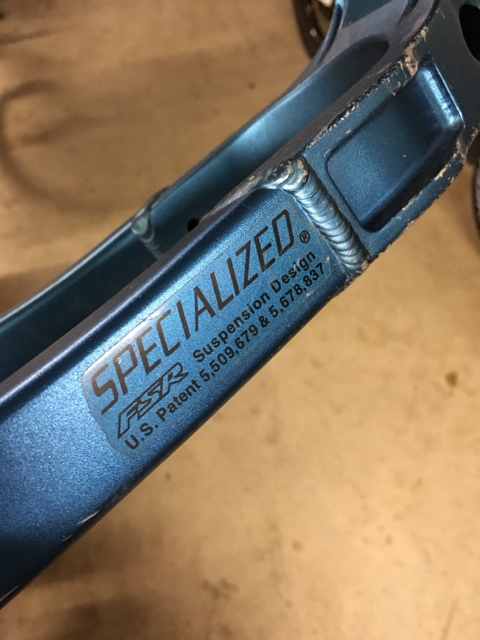

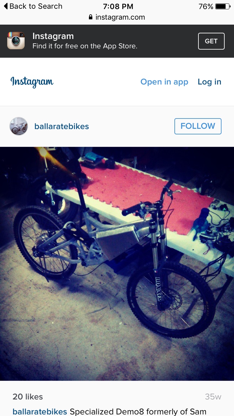

And see this Demo 8? Sam Hill (look him up) won the world championships on it in 2008. The signatures on the downtube hang proudly on my shed wall.
There are discerning riders here.
Suggest you don't bring a knife to a gunfight.
