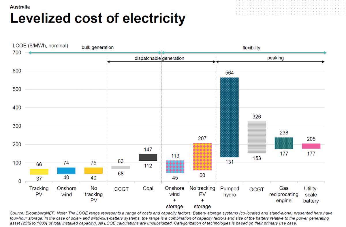

Here is a question for you all..
Below is the latest LCOE data for Australia from BloombergNEF
What is the most cost effective way of providing 1MW of power, continuously. (Utility scale for a 24 + hr period ?)
I suggest you use a mid range average for each technology.
https://imageshack.com/a/img922/6258/Zfl7C3.jpg
That's an interesting chart and seems to back up the decisions being made in electricity supply in many countries as being driven at least partly by economics and not just ideology. "for use when it's available" power, solar and wind are the cheapest source of generation. Of the fossil fuels, I'm surprised to see how much cheaper combined cycle gas is compared to other fossil fuels (and nuclear) and justifies its popularity for both baseload (lower CO2 than coal) and as peakers (it's real charm), filling in around cheap-as-chips, but intermittent wind & solar.
The other genuine surprise is that both solar + storage and wind + storage are cheaper than coal.
Sorry Hillhater but I can't see how that chart makes any argument for coal use. Gas all the way with solar & wind when its available seems to be cheapest option. And the lowest CO2. And the lowest air pollution.
