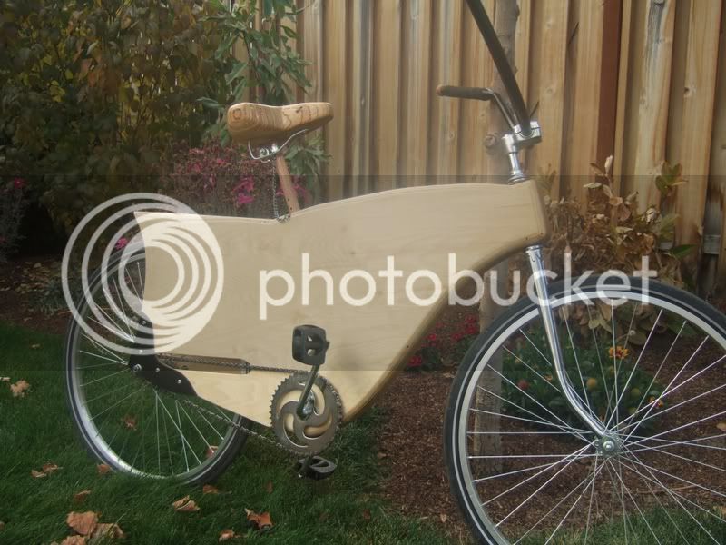

High school shop project, Marco Facciola

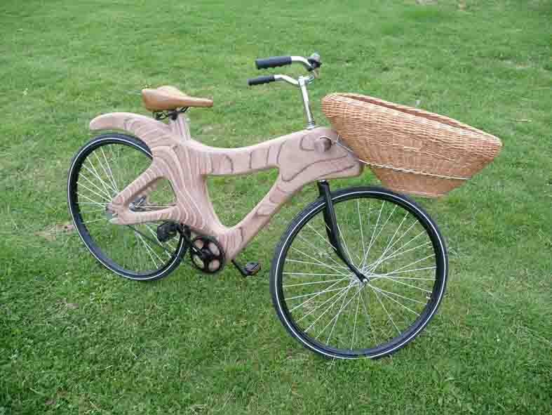

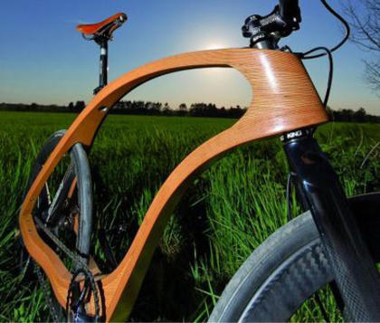

Two from Igor Ravbar (steam-bent strips glued together and cured while clamped in a form)

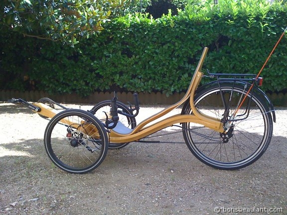

Bernd Vonau, SWB recumbent
