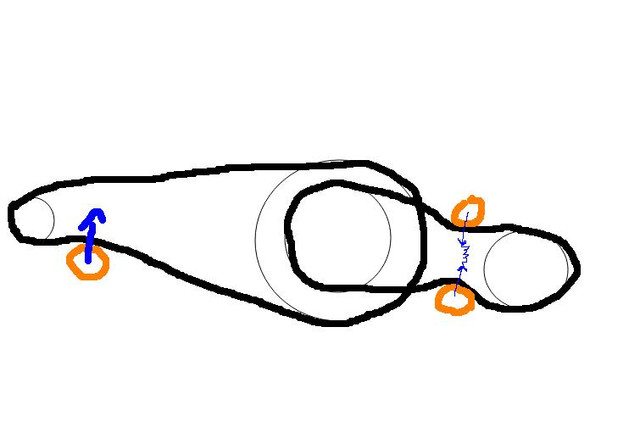

It is possible to design a system that can shift gears and keeps tension on both sides of the chain, and keeps a straight chainline...but you'd be designing and machining parts to replace existing bits inside various bike parts.
If you took two identical rear clusters at each end of a chain, and disabled (welded?) the freewheel clutches on them, and flipped the one in front 180 degrees, so it's narrow end was inboard, then made a derailer that would always pop the chain off the larger gear first, down to the next smaller one, just before it tried to shift the other end to the larger one, and there was only enough chain to ever wrap one set of sprockets this way, not extra chain like there is with a regular tensioning derailer, you could shift gears with a straight chainline at all other times than shifting. Because there's no "extra" chain, it should also keep tension easily enough (you could add a tensioner top and bottom if necessary, but it may have to release tension during shifting).
IIRC Naeem (numberonebikeslover) did something like this on one of his bikes a decade ago or so, but I don't remember how well it worked for him.
This is more or less how a belt variable transmission works in some systems, like in a drill press, and kind of how a conical-pulley belt cvt works, whcih are also systems you could use for shifting gears in such a system as you want to make...it's just a lot of custom work to get it all going together on a bicycle.

What changes when motor braking, is the chain tension: under normal power, upper chain half is under tension, while when braking, the lower chain half is working, correct ?
That's right, that's why it's now advisable to have a chain tensioner or guide that takes into account that the tight side becomes the loose side and the usually loose side of chain becomes the tight side. Simply: good to be tensioners on both sides, and springs long enough for the springs to stay in place but also not squeeze too much.
So I have such an arrangement, though I have not yet needed for a longer chain a tensioner on the upper side. Has worked quite perfectly with two tensioner rollers on primary chain.
https://ibb.co/WHRNJkC
