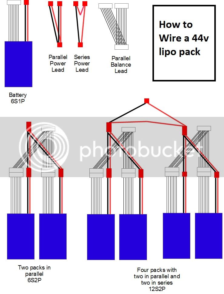

I'm halfway sold. I found this charger, which if I limit myself to 6 batteries, would seem to be an easy solution for charging 6 batteries at once.
http://www.buddyrc.com/icharger-306b.html used with this http://www.buddyrc.com/paraboard-v2-xh-xt60.html
I would probably build a 12s2p pack using 4- 6s 8000mah which should give me a 44V/16ah
Later I think I could easily expand to 12s3p and have 44V/24ah. (There's a chance that my commute may double in the next year.)
I'm guessing with this system I would have about a 4 hour charge time, maybe less?
This feels like a pretty well balanced package using a 500-1000W motor (MAC or something similar). I should be able to achieve 25+mph with a sacrifice in range, or plenty of range by limiting myself to 20-22mph or adding some human power.
What I like about this idea is that it gives me a smaller lighter package without greatly increasing the complication. I think the initial cost is a wash compared to LifePo, but less cost going forward after that.
What say the masses?

OK but as a noob here's what I see.
With the 12s charger I won't have to break up the packs, but will have to parallel the balance plugs and decipher which plug goes where and if I get it wrong I kill cells or damage the pack. Not saying it's not a good solution, but maybe above my skill level.
With the 6s charger and paraboard, I have to breakup the pack, but the connections are more straight forward (at least to me) and there's less chance that I will mess it up. That is of course assuming that I'm not completely misunderstanding all this stuff.
Assuming my plan of 4-6s 8000mah wired 12s2p for 12s 16ah, that's 4 batteries to charge.
Option 1) charge each individually with a single charger.
Option 2) charge each individually with 4 separate chargers.
Option 3) Charge all 4 at once with one 6s charger using the paraboard.
Option 4) Charge all 4 at once with one 12s charger.
Is my logic faulty?
You'll want to build your 12s2p pack like this.
Use 2 of these to parallel the the cells.
http://www.hobbyking.com/hobbyking/store/__32040__JST_XH_Parallel_Balance_Lead_6S_250mm_2xJST_XH_.html
Use a red marker to mark the high side plug. Use a black marker to mark the low side plug. Do the same on the boards that come with the charger, Hard to screw that up unless you're colorblind.
If you decide to go with a 6s charger and parallel charge, forget the paraboards and get one 1 each of these.
http://www.ebay.com/itm/JST-XH-6S-Parallel-Balance-Adapter-Balance-6-Once-/230626922768
http://www.ebay.com/itm/Parallel-6x-HXT-4mm-Bullet-Charge-Cable-/390639720613
These were used as examples only. HK website was down. These prices are higher than HK. many places sell these cables.

12s2p (10 ah) is a good choice. I started with a 12s2p and that was enough for my commute, which is 30km each way (60km round trip) with quite a bit of elevation changes and charging the batteries before/after each way. Also, I'm heavier and my bike is too probably. So, charging once for your 20mi round trip while reaching 20-25mph should be doable. I've recently gone up to 16s for more speed.
And the best way to build that pack is to use 6x 4s or 4x 6s lipos, with the 4s being cheaper (my 6x 4s packs cost me around $150 + shipping) and the 6s being simpler. Here's my 12s2p from 4s packs:
The harness is basically just a series adapter (made from 14awg wires + Deans connectors) and 3 parallel adapters:
If you're going with 4x 6s, then the harness is easier. You can just buy a series adapter and 2 parallel adapters and you don't need to solder anything except for changing the connectors of the lipos and ESC. So let's say you want to use xt90 connectors, then you can simply get the following:
Your 6s 2p diagram looks good to me, similar to how I do it.
But your 12s diagram look wrong to me. One 6s bundles + connects to the other's -. Then the remaining + and - connect to the bike.
I think you mean that, but it just looks funny to me in the drawing.

Simple way for 12s2p.
