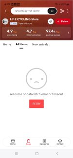

They look cheapest on Ali Express. I’m looking at this one, with no battery, C965 display, and Brake Lever selected. Am I missing anything extreme? Any red flags you see?
Yes, it's on aliexpress. ;)
Remember that whatever you get from places like that won't have any support, no warranty, no guarantee you will get what you ordered, and it's likely they don't know anything about what they sell, and even likely that their ad page is copied from someone else's ad page for a similar item so what you get may not match what's on the page. (that happens on ebay, amazon, etc as well)
That's a nice price .. $373 shipped out of a USA warehouse for a BBS02B. Seems to me, you're going to pay at least $300 for a hubmotor kit.
I've had a BBS02B conversion on a department store Diamondback bike in 2016. I rode it a lot the first two years. but don't need its top speed, around 26 on throttle. I bought a new wheel and put a disk brake up front. Didn't need it, Riding it slow, I used the original chain/freewheel, planning to change when it wore out, but it has not, but to be fair, it only has about 2200 miles on the conversion.I think it's a nice motor.
I buy a lot from Aliexpress&that store looks fake.No history.When I buy from a unknown store I go look at the store and it's history.Aliexress may protect you from a fraudulent seller but you have little legal protection. Just use caution and be diligent to make sure it is a legitimate seller. I have a BBS02 on a road bike and it will do 35 mph throttle only with a 48v battery but it gets hot.I watch/limit current. I would suggest a Direct Drive motor for a bullet proof motor. You can run full throttle with having to worry about the nylon gears that are in Mid drive and Geared hubs.All 3 style of motor go about the same speed.Higher voltage is higher speed. 52 or 60 volt is what I wish I had used instead of 48v.
I am not affiliated or advocate for the store just using for example of what appears to be a legitimate store. My internet is really slow and wouldn't load everything.
