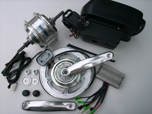

Here's another Ananda-based hub motor kit (note the crankset / chainring torque sensor, shameless plug for those interested in this particular aspect: http://www.pedelecs.co.uk/forum/electric-bicycles/1172-home-made-pedelec-pedal-torque-sensor.html#post62512 ):
http://www.e-bicycles.eu/en/index.html
The 155mm rear option is a real pain. Even if you have a steel frame bike you can bend, you'll find it doesn't work well anyways - the chainline won't allow you to get down to the smaller cogs on the freewheel without the chain wanting to come off the front chainrings, and the spacing sux - you can't get more than a 5-speed freewheel on there without spreading the dropouts even more.
