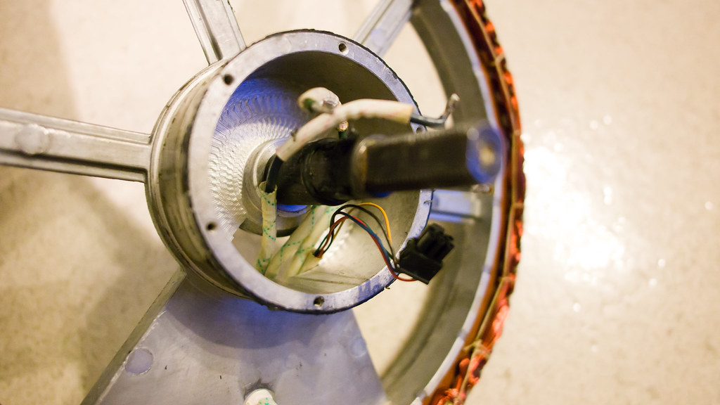

Hi, Thanks for asking :lol: The GM china sent me a replacement controller and everything was working like 5 seconds. I did test drive and the hub motor broke down. Here's the video of the problem... http://youtu.be/fIFtIuJn7_E and here is what happened:
So the washer in the hub broke down and caused stuck between stator and magnets. Four magnets are also broken because the washer was there in the wrong place...
these washers...
but stator seems to be ok...
I'm waiting new washers from GM China. I think they should send me a new motor. I'm lucky because they have very good customer support. So what I learned here...Don't buy from China if you don't get warranty and good customer support. I will post more info when I can assembly my wheel again and do some test driving. Some day I will enjoy my ebike but not today...
O well I know how the motor looks inside.

Yes, lot of noise, Like...scraaaatchhhhh... :) I hope my bad luck turns better...
MAGICPIE3FOCUSPOWER said:
Hmm I am still curious how it's possible the circlip is broken or came off the stator axle.
Yes it's a good motor after doing a lot of mods.
Circlip, weakest link of the chain...or just my bad luck.

Well the circlip doesn't move at all o well I think you have bad luck.
So where was the circlip located. I don't know? With two washers and then circlip in the casette side axle?
