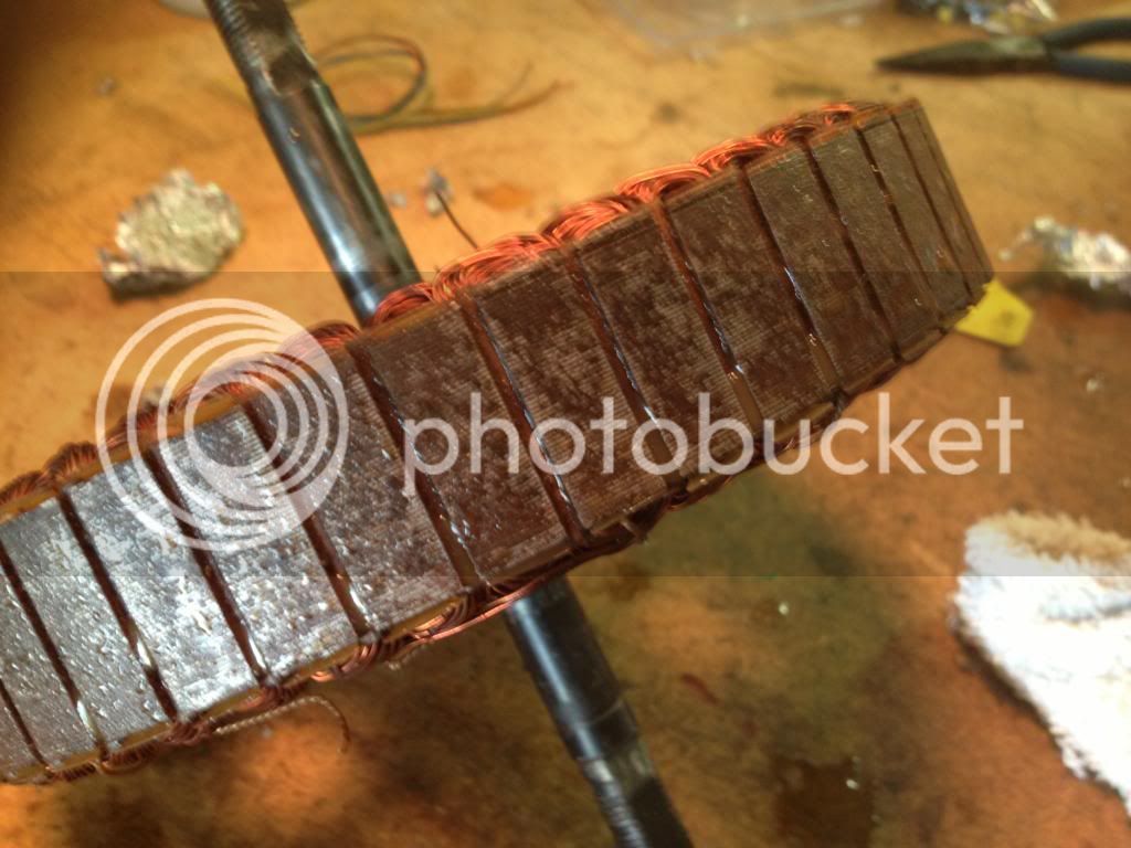

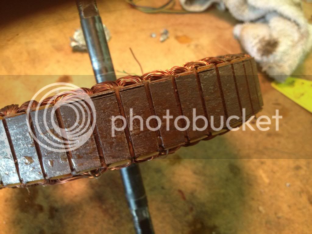

RUST: DIY Hub Motor Repair & Restoration
Apple cider vinegar + aluminum foil+beer (not for the motor)
Before with a coating of vinegar
After minute of rubbing with aluminum foil
After an additional 5 minutes of rubbing
going to the store for a little aluminum brush (if there is such a thing :p )
3 hours later
Small Update

The rotors were also cleaned-up one last time and wiped down. Then spent 4 days varnishing using the same stuff as DocBass except I liked the green color better – being EV and all. Or it could have been that was the green stuff was the automotive/industrial strength… whatever. Doesn’t matter now; I’ve got the goods in hand and it worked pretty well. With varnish, spray on light layers and allow to cure, otherwise it stays tacky for a long time and is a pain to handle the parts cos yer off to the sink trying to scrub it off yer hands. PitA.
