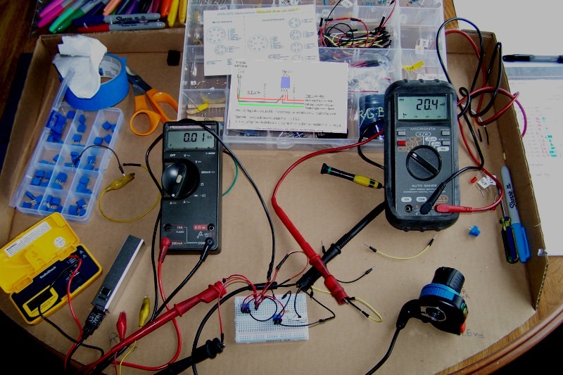

Meter test:
With a new battery, meter set to auto-range, it now reads only 2 ohms instead of the previous 10 ohms it had with a weak battery. With leads removed and a copper jumper wire across the sockets, meter set to auto-range, it drops all the way down to .02 ohms.
From this test I conclude that my meter is fine, but my leads are not. I'm not sure if they are bad enough to affect other readings such as voltage though.
Pressing the Range button four times fixes the range to either 32k or 320k ohms. Touching the leads together with this setting gives a reading of .02 ohms, which seems likes good setting for testing my harness, so I retested it.
I agree on the less than perfect lead(s). You can always keep the 2-ohm offset in your head. But if you plan to use your meter to say, check charger voltage and amperage cut-off setpoints. (Need high accuracy here...) Get new leads... yep, they are expensive. On my fourth pair.
