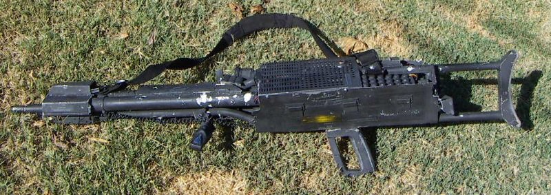

While I'm not an expert by any means, I have more than a couple of decades of experience with using and forming (thermally mostly, like vacuform, etc) many kinds of plastics in both good and bad ways; I used to scratchbuild plastic (and ohter materials) models of various kinds, primarily scifi stuff, and handheld and costume scifi props (mostly "ugly guns" and the like), and learned quite a lot about what you can and can't do with different kinds, how they age (well or badly, etc), adhesives you can and can't use, and so on.
Some plastics I stayed away from because they aren't easy to join, or paint, or some other characteristics, so have less experience with those (PE and HDPE, for instance). Some, like TPU, didn't exist or weren't something available to me back then, but I've since worked with forming and shaping and sculpting some versions of TPE and TPR, which experience may apply to the TPU if I'm lucky. ;)
Apparently most of the images of things I've built are gone, but there's a few of a very crudely-built giant ugly-gun here:
