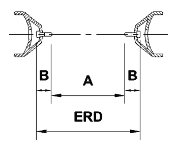

Effective Rim Diameter (ERD)
ERD

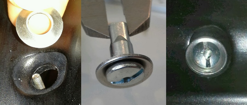

You can also add washers under the nipple, in order to use a certain nipple in a larger rim-hole.

Nipples
The nipples should have their threads fully engaged all the way up to the slot in the head. It is better for the spoke to be one mm too long, than an mm too short.
Sapim Polyax
Sapim hexagonal
Pic courtesy of the Serotta forum
_________________________________________
Put the nipple on an extra spoke in reverse, it makes it MUCH easier to get the nipple onto its destination spoke.
How to easily get a nipple onto its spoke
2015-03-11 10.26.54.jpg (88.67 KiB) Viewed 16232 times

I've built about 10 motor-wheels that needed the rim offset. I've never yet used two different length spokes. The spoke calculators normally give about 1mm difference. I buy my spokes from stockists who never have the exact size the calculator gives anyway, so I take the nearest standard size. When you use double-walled rims, there's plenty of room for the spoke to poke through the nipple. You can go up to about 5mm before you run out of thread. Obviously it's best to get the correct size spokes. What I'm trying to say is that it's nothing to panic about if you want to use some that are not quite right. I would say that a practical tolerance on the spoke length is something like -2.0mm + 3.0mm. If you have shallow rims, the plus tolerance would go down depending on how shallow it is.
If you get a rim with eyelets, 13g nipples are often very tight, which holds the nipple at 90 deg to the rim and very tight to turn. It's better to go down to 14g spokes and nipples, which will allow the correct exit angle for a one-cross pattern. You might get two-cross if you have a large rim or small motor.
I'd say that's a major benefit to E-bike wheel-builders. Plus with the added weight of the hub in the wheel, when hitting a pothole, I would think all E-bikers should consider the added strength of a double-wall rim a requirement. Thanks for that info.

Regarding being able to use longer spokes than necessary because of the thickness of a doublewall rim:
http://www.endless-sphere.com/forums/vi ... 0&p=819422
I had to do something like that then, and so far, after grinding off the "excess" spoke length that actually stuck out beyond the top wall of the rim (because mine were so long that the extra thickness made it possible but only helped *some*), it has worked out just fine for months, on CrazyBike2.

http://www.kstoerz.com/freespoke/fullcalc This is my favorite spoke calculator. The visualization and the ability to accurately put all of the numbers in (such as spoke bed offset) is something I really appreciate. However, I still use wheelpro.co.uk calculator as well, I think they add .3mm to the calculated lengths, but they show spoke angle (hover the mouse over the calculated lengths to see it). Kstoerz.com also has a list of rim/hub measurements which is extremely useful when hunting for parts. Ebikes.ca is a fine calculator, but I feel like it is incomplete, missing key features that you may come to understand are important.

Also there are numerous spoke calculators on the net including the AWSOME one on the Grin site, but I found this one.
http://kstoerz.com/freespoke/fullcalc
I found particularly useful for e-bike builds because of two features. First the ability to easily build in dish with a separate entry box in the calculator. Second, the graphic representation of the spoke angles once the calculation is made. You can easily see just how close the dished side spokes approach verticle with your given dish. Try it out I think you will like it.

Use at least 2 spoke length calculators. If you do get the length wrong, your supplier might be happy to shorten them a bit more for minimal cost. He can't make them longer though.

Rims that have the washer at the nipple hole seem to tension smoother, as compared to just a hole in the rim.
