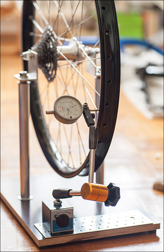

My truing stand is a rather simple affair. Made from a piece of plywood, two 25x3mm aluminum tubes, two M10 thread rods, two aluminium brackets and a couple of washers and nuts.
Works as a crude hub motor test stand as well.
