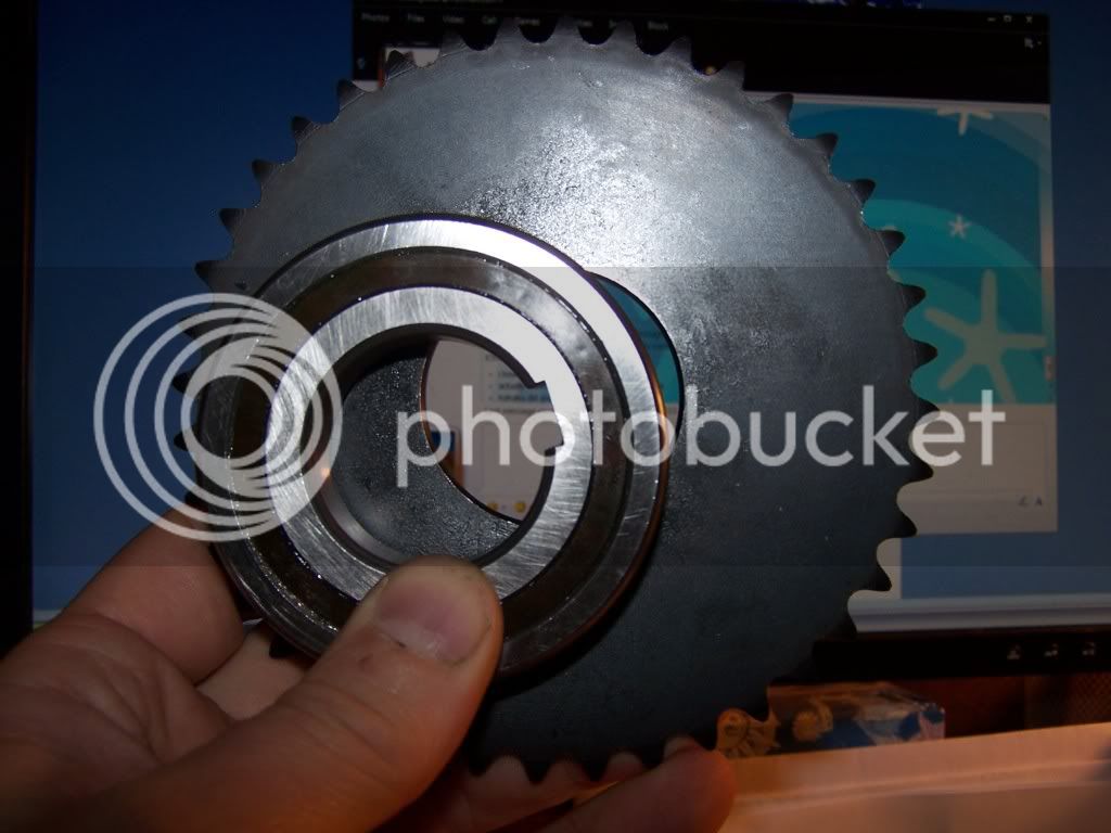

before i build my own has anyone (other than randy i know that one wont do 70mm) seen or know of method of attaching this gear to the od that will allow me to easily swap gears ?
this bit gives me isolation from the motor when i pedal and puts the icing on my first build . thread to follow
I guess you'd need to make a collar for the bearing to press into (or otherwise be fastened into) that has an end-plate with bolt holes on it for the sprocket to bolt to.
If the bearing's outer race is keyed like the inner one, you'd probably want to use that keyway to ensure no rotation within the collar, given the torque I expect you'll be putting thru that. ;)

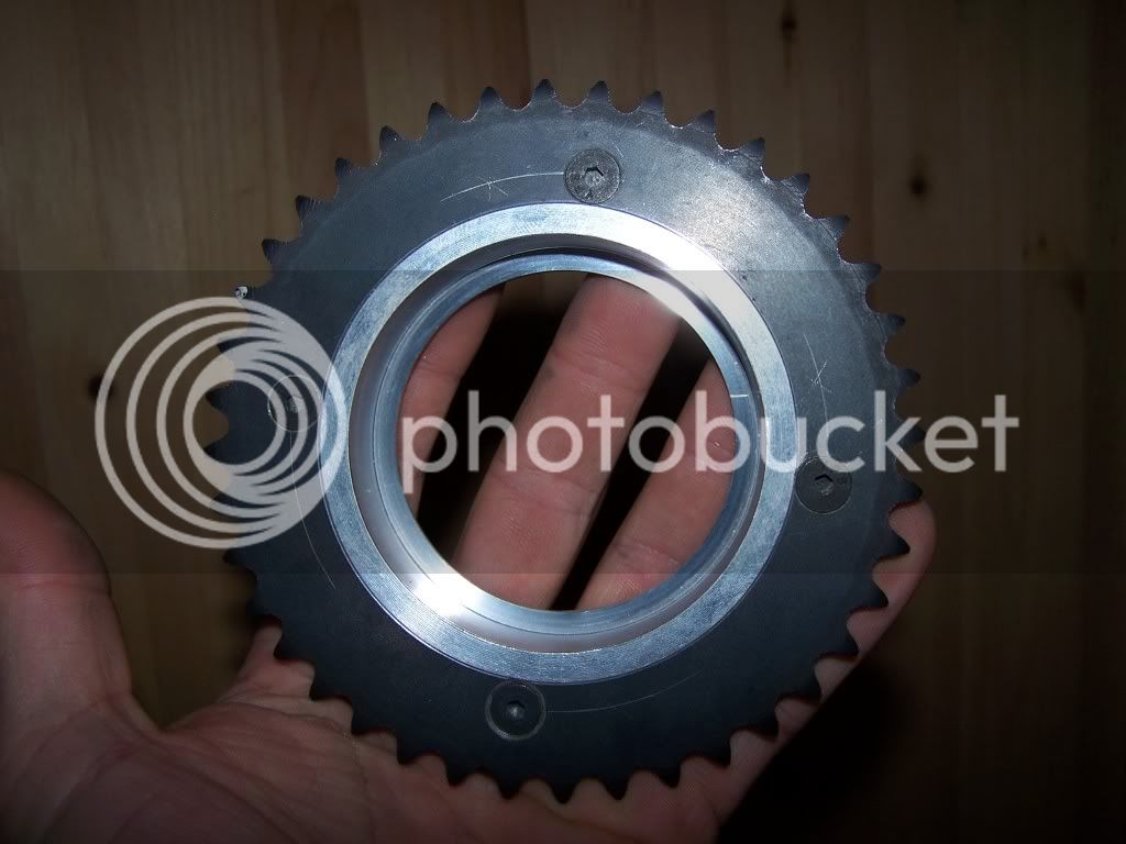

the alloy is on the lathe now . soooo close

Stumbled across these, sometimes it helps to know that something exists, and also knowing the industrial trade name...
A CSK-P has a keyway on the Inside-Diameter (ID), and a CSK-PP has a keyway on the ID and also the Outside Diameter (OD).
None of the listed IDs/ODs help me, but I thought they might be useful to someone else (perhaps other IDs/ODs available from some other company). Miles, I like the way you did yours!...
http://www.stieber.de/pdf/stieber/CSKP-product-en.pdf

i dont know what the eno can handle but i can tell you this bearing has absolutely 0 noticeable runout, 0 backlash and is silent like death.
we will see if that holds up after i pump 12kw through it later this summer :twisted: for now we'll start with 6kw
