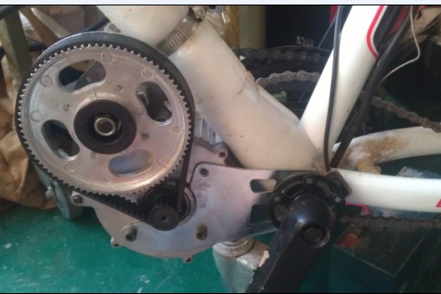

Reduction:
edit: primary drive is a toothed belt, 14T-80T (ratio 5.7:1) and the secondary drive chain is 12T-44T (ratio 3.7:1) overall gear-down from motor to BB is 3.7 X 5.7 = 21.1:1, chainrings are 4-bolt 64mm BCD, The internal BB width of the mounting bracket is 68mm, Laser-cut steel is 2.5mm thick, BB is 150mm wide. The primary belt is 5mm pitch / 15mm wide. Motor case is 120mm dia / 70mm wide, weight of complete drive assembly is 4.3kg. There's a new thread about just the primary drive upgrades here: http://endless-sphere.com/forums/viewtopic.php?f=28&t=46738
Edit: as of the spring of 2015, GNG is shipping all new belted primaries with a 20mm wide belt, instead of the original 15mm wide.
Jack shaft NO-LOAD output @ 48V = 570-RPM, so with 12/44 second stage no-load cadence will be 155-RPM, the chainring that drives the stock chain to the rear wheel is a 38T (many thanks to ES member "full-throttle")
. Unloaded motor kV is approximately 67.
The 36V kit is $80 cheaper and brushed, also it uses the noisy Currie-style metal gear-reduction.
The 48V brushless kit has an external belted reduction to a jackshaft, which also allows an off-the-shelf freewheel (Dicta?). I like the mounting bracket, which should allow it to be mounted to a wide variety of frames (can be easily upgraded to a White-Industries ENO/ACS-Crossfire). Pics of how the bracket attaches to the spindle cartridge on pg 67 http://endless-sphere.com/forums/viewtopic.php?f=28&t=42785&start=990#p686296 Stock belt here: http://www.ebay.com/itm/221012653265?ssPageName=STRK:MEWNX:IT&_trksid=p3984.m1439.l2649 if EBAY link is old when you read this, it is a HTD-5mm pitch, belt is 15mm wide and 475mm long with 95 teeth. The Goodyear version of this belt is considered to be better.
Kit does not come with a battery or charger. It appears to be direct-shipment from China, so no North-American dealer, plus, returns would be a hassle.
Motor:
Motor is an inrunner about 4-1/2 inches diameter and about 2-1/2 inches wide. A very good size for a BB-drive. Bigger may be better for performance, but a bigger motor would have a hard time fitting most frames. Since the motor size is a limit on whats possible for most bikes (in that frame location), the fact the motors 67-kV is set for a BB-drive @36V-48V is a great choice. Motor internal pics (thanks christerljung): http://endless-sphere.com/forums/viewtopic.php?f=28&t=42785&start=780#p674715 plus some motor specs: http://endless-sphere.com/forums/viewtopic.php?f=28&t=42785&start=825#p675568

Cool, that looks like a nice mid drive to me. Should be quieter than the currie-style system for sure. The motor looks a lot like a knockoff of a small MAC / BMC, as well. ( ecospeed uses those ! )
I like the mounting system! Using the BB as a mounting point is smart. This is a big improvement over the cyclone kits.

Very interesting design, if that inrunner has a good thermal path from the windings to the case, this would be more capable than the cyclone style motors in terms of power handling. Hmmm... very tempting.
Time to look at unite motors to see if this is one of theirs... All of the others look to be unite.
Looks like the motor used on their transaxle - http://szunitemotor.en.made-in-china.com/product/WqhmifFDnIcK/China-Transaxle-Motor.html
They rate it 48V 500-1500W.
I have not purchased one. The motor runs the appropriate RPMs to be a BB-drive at 48V. That has been one problem with off-the-shelf motors. If a motor has a kV that makes it work well at 24V (or in some cases 36V), it will be spinning too fast when using 48V. Since this has a two-stage reduction, there are a couple places where a sprocket could be changed to a different tooth-count if needed, but since this motor already runs at the right speed at 48V, no sprocket search-and-change is needed.
The controller is easily upgraded, but the mounting bracket does not easily allow a different motor to be swapped in. If the motor has neodymium magnets, I am leaning towards buying one of these. I don't know what the amp-limit is on the stock controller, but if it will allow 25A, it would save me $50 (it will likely cost $50 to get a different controller).
