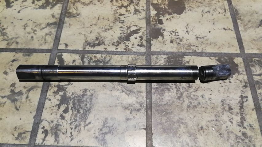

Hi all!
I have this issue were my 120mm axle of my Fatbike with TSDZ2 motor broke for the 2nd time. I'm really wondering how this could happen. Here are some pictures for your amusement... =)
Could heat play a role? I did have an issue with the retainer ring which did not fit too well and did not 'lock' the axle so it had some play moving left/right.
Future-Bike mentioned that I replaced the original cranks which came with the set for a set Miranda cranks. It does change the offset but could that brake the axle?

I'm talking about the axle connecting my cranks. It broke exactly were the retainer ring is supposed to sit. Now I'm thinking about what you said.....
Let's say that when I'm standing on the pedals without pedalling (so making a twisting motion on the axle) and for some reason the motor will activate because the torque sensor noticed some pressure it might be possible that this can break the axle.... ?

It looks less like a break to me other than a break down of a manufactured joining of two parts? The spindles are very clean on both parts and there looks like a machined shoulder on the smaller section that it is not clear if there is more inside the longer part of the spindle? Whatever that small shoulder is not at all large enough to support the pressure of a crank arm under power.
It also looks like there is similar joint on the other side of the spindle like they took a stock bb spindle, cut it into two parts and sleeved them into a longer section in order to make it work for the wider bb shell. All in all it looks improperly engineered to me to begin with. That whole spindle should be made from one piece and heat treated properly.
Circlip's on the BB spindle have been around since the early Gary Fisher days, with no real problems. It's not the
greatest idea, but throughout time, it doesn't have 'all' that bad of a rep.
Like amber wolf says, it's a high stress riser because of the sharp edges in the grove, it really should be a round grove
instead of a square grove. Even better yet, no grove at all,.. and use tube spacers between the crank arms and BB to
center the spindle. But whats done is done, and your stuck with it on that drive.
I would suspect that you have a bad batch of spindles, or perhaps their all bad, or your body weight is a lot, and or

Im gonna attempt to weld mine. ive got two broken ones, the hole for the pedal arm is drilled unneccessary long too which weakens the axle, there is also a groove for a c-lip, so the metal is very thin where it breaks. I cant find the long axle as a spare part either, only the std 68-70mm crank type.
The bearings supporting the TSDZ2’s spindle are 15mm inside diameter. Normal pedal bike bottom bracket spindles are 17mm, and this is demonstrated to be just big enough for reliability. The Phil Wood spindle in the link is 17mm.
I note with some horror that the designers— I refuse to call them engineers— of the TSDZ2 have put a snap ring groove In the spindle, right at the point of highest stress. This is a known problem since the 1970s at least, when Viscount/Lambert bikes were equipped with a similarly grooved spindle, and suffered chronic breakages.
I’m sorry to say that the problems with this spindle are by design, and can’t be fixed. Welding a broken spindle will create a heat affected zone and material discontinuities, causing the repair to fail even more quickly. Short of replicating the part in some absurdly strong material like maraging steel, there’s nothing to be done about it.

I have TSDZ2 BB100mm (500W, 48V) on my Fatbike and got my shaft broken yesterday (after 560 km use). I have sent message to Ebird Store and waiting their comments. Anyhow... shaft was broken from circlip groove, chainwheel side. Motor is still mounted to the bike. ==> Is there instructions somewhere how to remove this broken shaft.... can motor be mounted to the bike.... do I need to remove also torque sensor or is it possible just to pull out the shaft??

You've been a great help. So we know that it's not just 120mm spindles that are breaking.. it's also the 100mm ones. You've also confirmed that the defect is not just in future-bike.it, but also in the other shop chain.. so all supply chains are likely shipping bad spindles.

Hole for crank mounting bolt is way too deep.... it could be almost 10 mm shorter and then shaft wouldn’t be shallow at the circlip groove area ..... bad design I think.
If the hole ends near the location of the groove, the stress riser of the change in section could have more effect than a deeper hole. The snap ring groove is the biggest problem, followed by the insufficient outer diameter of the part. These spindles would be breaking just about as often even if they were solid.
Holes along the axis of a shaft don’t have much effect on structural integrity, because stresses are highest in the skin and negligible near the center.
