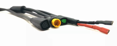

The cable out of his controller is 8 pin male, and you can plug in a 1T4 harness cable like the ones used for the BBSXX Canbus motors from Varstrom or the ones from PSWPOWER.
But if a cable (seems for M500 and M600) from the picture below (with lights connection at the front) fits too on a BBSXX Canbus then at which pins on the BBSXX canbus pcb connects it... If it can be plugged in, i expect that will give unexpected results on a normal BBSXX Can motor compared to a 1T4 cable... So i wonder if the controller from Jakuda87 is a normal version or a special version once made for some big client because also his power connector seems to have some extra small pins, maybe for batt. communication or so.

I looked at wiring diagram for the above cable and that positive wire from front light ends up at the PCB on the pin marked "brake".
And that is what Jakuda87 also measured on his BBS01 canbus controller.
if using a 1T4 cable then it is the brake signal line that ends up on the PCB pin marked "brake".
