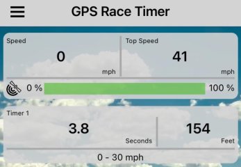

I've been playing around with an app call GPS Race Timer on and off. There's a section of road at the bottom of the hill with no traffic, at least for a few hundred feet for testing. I usually do a couple of runs when my battery is charged up, then go for a longer ride afterwards.
Besides weight, I'm starting to conclude that traction/tires is a significant limiting factor for acceleration for an ebike when using bicycle tires, even if the bike has power to accelerate quicker. After the tires hook up, power becomes the bigger factor, and where in the curve that power is located.
I'm using this thread to log results of doing small tweaks to see how they affect 0-30MPH times. I'd be interested in how other ebikes perform as well.
I setup the app initially testing 0-20MPH times. The data was fairly consistent, but I felt 0-30MPH would better represent the range I normally ride in. 0-20MPH times were around 2-2.2 seconds, heavily dependent on the launch. 0-30MPH times hover more around 4 seconds, and 200 feet, in my initial tests. I launch the bike the same way I would with a motorcycle, body weight forward, flat in almost a prone position. My head is over the front wheel. My best times happened when I can keep the rear wheel from losing traction, and the front tire is about 6" off the ground for the first 30 feet or so. I think if I could get my weight more forward without losing traction, then more of the power will be used to accelerate the bike forward, but that may be the limitation of bicycle tires. The weight savings would also be a factor.
Here's one of my runs from initial testing:

Apparently my first test was invalid. I'm pretty sure I didn't set my three position switch to high on my earlier run. I tried a single run today when I went out to grab some take out. For this run, I added some lipo packs in parallel with my 52V pack, to eliminate voltage sag (7V > 1.5V sag). This time when launching, I shifted my weight even more forward and only lifted the front wheel right at the start, but was back down within a few feet. I don't think this was enough for the improvement I saw, so my conclusion is that I likely had the controller set to either low or medium on the earlier run. I think the lipos helped more in the 20-30MPH range, since it felt like the bike was pulling a lot harder than last time in the upper range.
Bike weight: 84lb
Total weight: 261lb
Motor: Leaf 5T
Controller: 70A, 200A phase
Battery:
20S: 52V28Ah 14S8P 40A/60A peak in parallel with 3Ah lipos + 24Ah 6S lipos
Total voltage under test conditions: 82.5V
Tires: 24x2.8 @35psi
I'll try lowering tire pressure next.

So plan on testing this app today with my new super Moto wheel, QS205. I’ve tried this app briefly before but when I launch/Holeshot the app doesn’t start, am I my missing something here? Doesn’t the app start when you accelerate? I’m curious to see what the acceleration time is as my overall tire diameter is 21 inches, 16” Moto rim.
I noticed that it needs a good signal to work properly. It wasn't reliable if I had my phone in my pocket, but if it was mounted on the holder on my bike, it starts as soon as the bike moves. I haven't tested the accuracy, but maybe I'll see how it works in my car compared to a stop watch.
