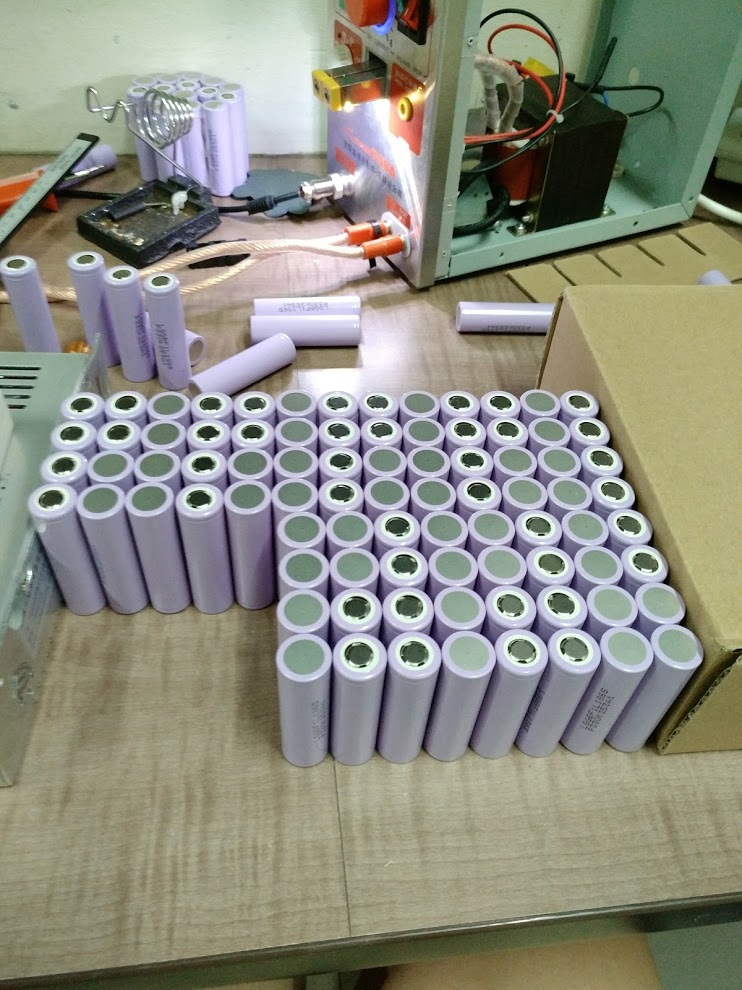

Building my first battery and looking for advice. Looking for around 72V so i'm thinking 20S 5P or 6P. I've got the sunkko 709 spot welder. I'd prefer to use NCR20700A which are 3000 mah 30A. This pack will have 150A-180A so I need some hefty connections. I can purchase dewalt packs and get great price and have nickel plated copper tabs already welded then solder copper wire for connections but that's not ideal to me. Next option is .02x8mm pure nickel strips with copper wire soldered for series connections. The ultimate option to me is this copper grid with Nickel tabs already welded. If the copper grids don't fit and multiple need to be connected can I just solder them before hand?

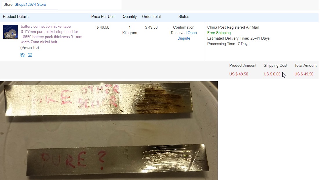

1 year ago I bought legit nickel from here
https://www.aliexpress.com/item/Thickness-0-2mm-Weight-1kg-Low-resistance-99-96-pure-nickel-for-battery-spot-welding-machine/32336236156.html?spm=a2g0s.9042311.0.0.umEoPb
and here
https://www.aliexpress.com/item/Free-shipping-18650-battery-nickel-strip-0-3mm-nickel-plate-18650-26650-cell-nickel-belt-Lithium/2050756060.html?spm=a2g0s.9042311.0.0.umEoPb
riba2233 said:
Great, thank you! 8)
Last year I ordered from 3 sources on aliexpress claiming 99.9% nickel, all turned out to be legit. That can change at any time if they change supplier or just oblivious as to what they are selling. Sretno.

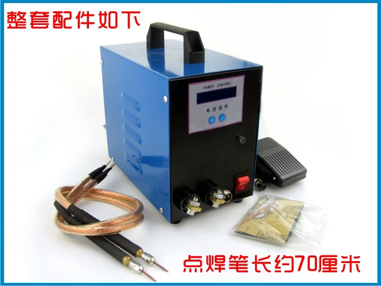

Yeah I've got the same one burn up too. Right now I'm using this spot welder that has a blue case and it's transformer is about twice the size of the 709A. I can measure the size of the core when I get home later.
I saw that welder as well when looking for a replacement. But in the end i would face the same problems with overheating and popping MCB's that i went "frock it" and bought a battery based welder. Much more effixient, no more extentions from the breakerbox for the dedicated D class MCB i had for it.
And it was a lot cheaper. But i would love to see a few pics of the insides of that welder.

Here you go, I have attached a pair of aftermarket probes to the spot welder.
The transformer is much bigger than the 709A
http://imgur.com/a/N8x5L

Yeah I'm looking for a Battery/Capacitor Discharge welder too, one that can weld 0.20mm nickel. right now this spot welder can only do up to 0.15 mm.
