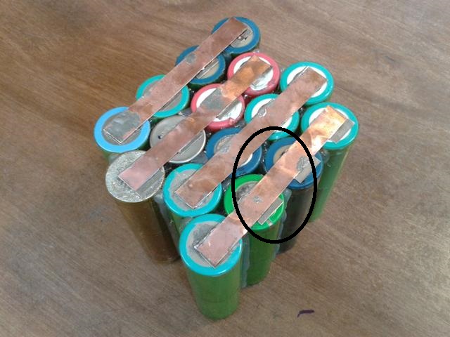

Yep to much labor and problem with oxidation.
Use double strips of 0.2x10mm on top of each other, like so(well you cant actually see that they are doubled).
In fact I have a better suggestion to you about your layout where you only have 1cell instead of 2 together like your pack today while maintaining the same measurements. With this layout you can even quadruple nickel strips - plenty enough to run your currents without even getting to the body temps.
Lets see if you can solve this puzzle :mrgreen: Its a 20s10p but hey, how is the rest of 5p connected? :wink:
Yeah :D The lower picture is the way to go ..... with that setup there will be 14 nickel strips for series connection instead of the 7 that I actually have. Then each strip will carry 11A that is a great improvement.
In the upper picture instead I do not understand how did you connected the series cells.
About the oxidation problem is it not present also on the soldered end of the balance wires on nickel strips?
Well you can still have 14 strips with your current layout where you have 2pairs of cells, just weld the strips on top of each other. But the lower picture is a better layout because you have a better current distribution with only 1cell in a row instead of two.
The upper picture shows a pack with 11p where I have 14 strips in total. 7 + another 7 on top of them.

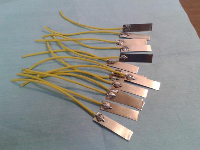

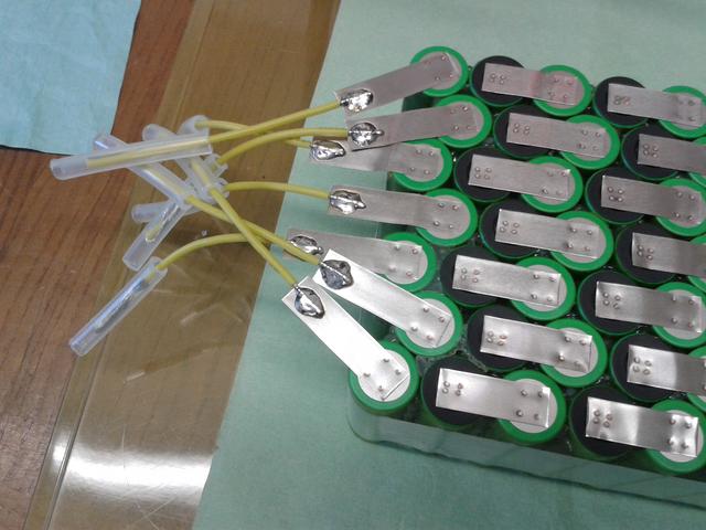

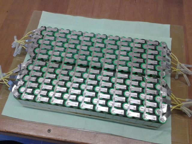

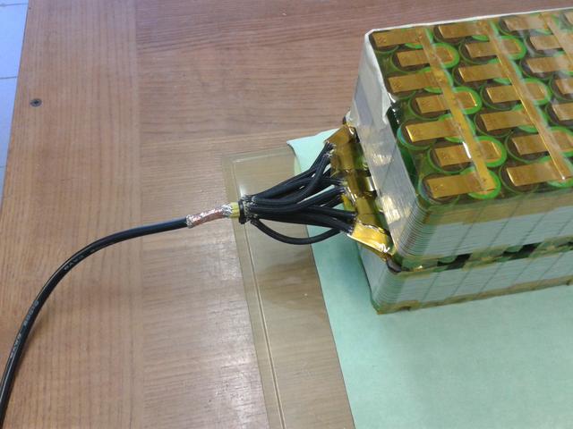

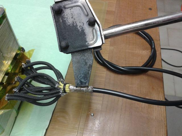

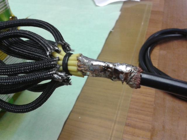

Last weekend I finished the assembly of my new 20S14P battery.
What do you think of the termination cables I made?
These are 14 18AWG cables soldered to a 8AWG one.
I guess it COULD kinda act as a fusible link if all goes to hell in a hand Basket?
I would think you need a whole bunch more of parallel connections? Looks like only a thin piece of nickel at each parallel run?
What cells and what is total draw from pack?
Tom
Parallel strips are 0.2mmx5mm and they should be good for 5A that in my opinion is more than needed.
The battery is made with 280 Sony VTC6 and in the worst case I will draw from each series 11,5A peak and 10,5A continuos.
