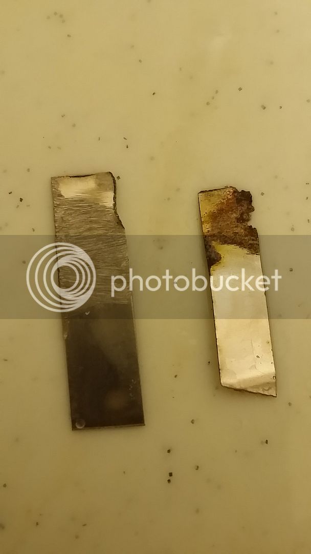

Careful where you buy that nickel from. If the price is even remotely too good, most likely it is steel plated.
Decided to test some nickel I own with the salt test and found some suprises :shock: .
To scratch the Nickel I decided to use a grinder. And look what happens when you scratch Nickel plated steel. Lots of sparks! I then grinded 99% nickel and no sparks in the video.
I read in a comment section on Alibaba that someone tests for nickel by using a dremel grind, and now I can see why.

You can see the rust on the Nickel plated steel on the right after putting it in salt water.
Just odered some .3 nickel strip from this place and it passed the grinding and rust test.
To make the rust test faster I use Vinegar, Hydrogen peroxide 3%, and salt. Mix this in a cup and it rusts stuff instantly (you can see lots of bubbles coming from where it is rusting), I let it sit anyway for a while. I found just using water and salt takes way too long.
Grinding test produced almost no sparks.
This is the same vendor who is recommended for the .15 nickel.
http://www.aliexpress.com/item/Free-shipping-18650-battery-nickel-strip-0-3mm-nickel-plate-18650-26650-cell-nickel-belt-Lithium/2050756060.html
Here is the .3 nickel strip on left (no rust) and some nickel plated steel on right that I throw in with the .3 nickel to make sure that rusts in my rusting mixture. Black marks on the left nickel is not rust but burn marks from grinding.
I've done this test on some nickel I have and after some nights in salty water one tab had some rust on top. But when I picked it up from the water the rust washed away. Was not like a normal rust which stays on the iron, this one forms like a deposit on top and when you move it washes way. But if you don't move it it looks like normal rust.

Did you grind it down to expose the steel? If you saw some brown I would be very suspect.
Salt added to water may not be effective enough to rust in such short time. I would grind it down a lot or file it down, then put, hydrogen peroxide, vinegar, and salt into a cup and drop it in there. It will rust super fast if there is steel. You will see tiny bubbles coming from the area it is rusting.

OK, you'll need the hydrogen peroxide 3%. It is cheap at like $1.00 at any store. I would also throw into the mix some steel item to make sure that rusts also.
