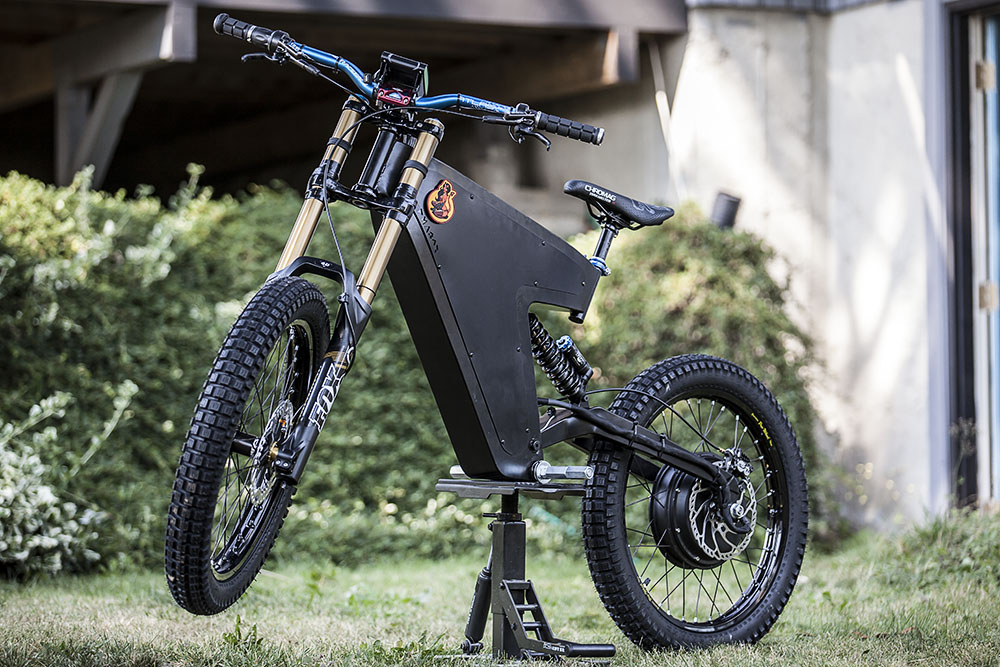

yep! now I'm at that trying to find frame/controller/battery quest..
dh frame needed, but they lack the space..
I needed it all in front to compensate for the weight of the rim tire and cromotor.
And to help keep your front wheel down under hard accel.
Ch00paKabra, very nice wheel set there, really like the anno blue rim color. Let us know how you like the setup with the MAC.

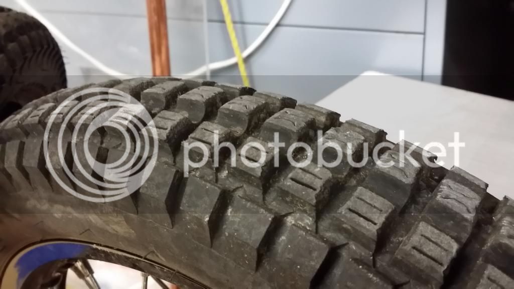

For your interest.
I ran 765 miles on both a 19x.2.75" shinko and a 17x3.00" shinko tire.
I took pictures to show the how much tread is left on the tires. I also measured the center tread depth.
The 17x3.00" tire looks to have a substantial amount of tread left after 765 miles. Although this isn't any kind of valid test because the 17x3.00" shinko tire started with a lot more tread.
The 17x3.00" is a clear winner however you put it, after 765 miles the 19x2.75 looks very worn out already while the 17x3.00" still has a lot more tread and life left in the tire.
I am not sure the tire compound, but the 17x3.00" feels a lot softer. The 17x3.00" was run on a 1.6" rim while the 19x2.75" was run on a 1.4" rim. The 17x3.00" tire was run with a lot lower PSI. I wonder if this lower PSI makes it wear less in the middle as it may spread out more over the knobbies.
Remember, if you're looking to go to a moto rim and plan to off-road, forget the 19x2.75 and get a 18x3.00", very similar in size but you get a much better tire with the 3.00" and it will probably last a lot longer also, plus its a lot more stable under any off-road conditions.
Here is the 19x2.75" shinko with about 4.75mm of center tread left.
Here is the 17x3.00" shinko tire with about 8mm of center tread left. You can clearly see how meaty the tire is after 765 miles.
Just some side by side comparisons.
Definately got at least another 1k on the 3.00-17 and probably about 300-350 on the 2.75-19. Glad you are liking the moto tires as much as you are. I wouldn't ride anything else on the rear of any ebike, ever again. And you will see why when I get dont editing my next video which has a good dose of lava rock.
