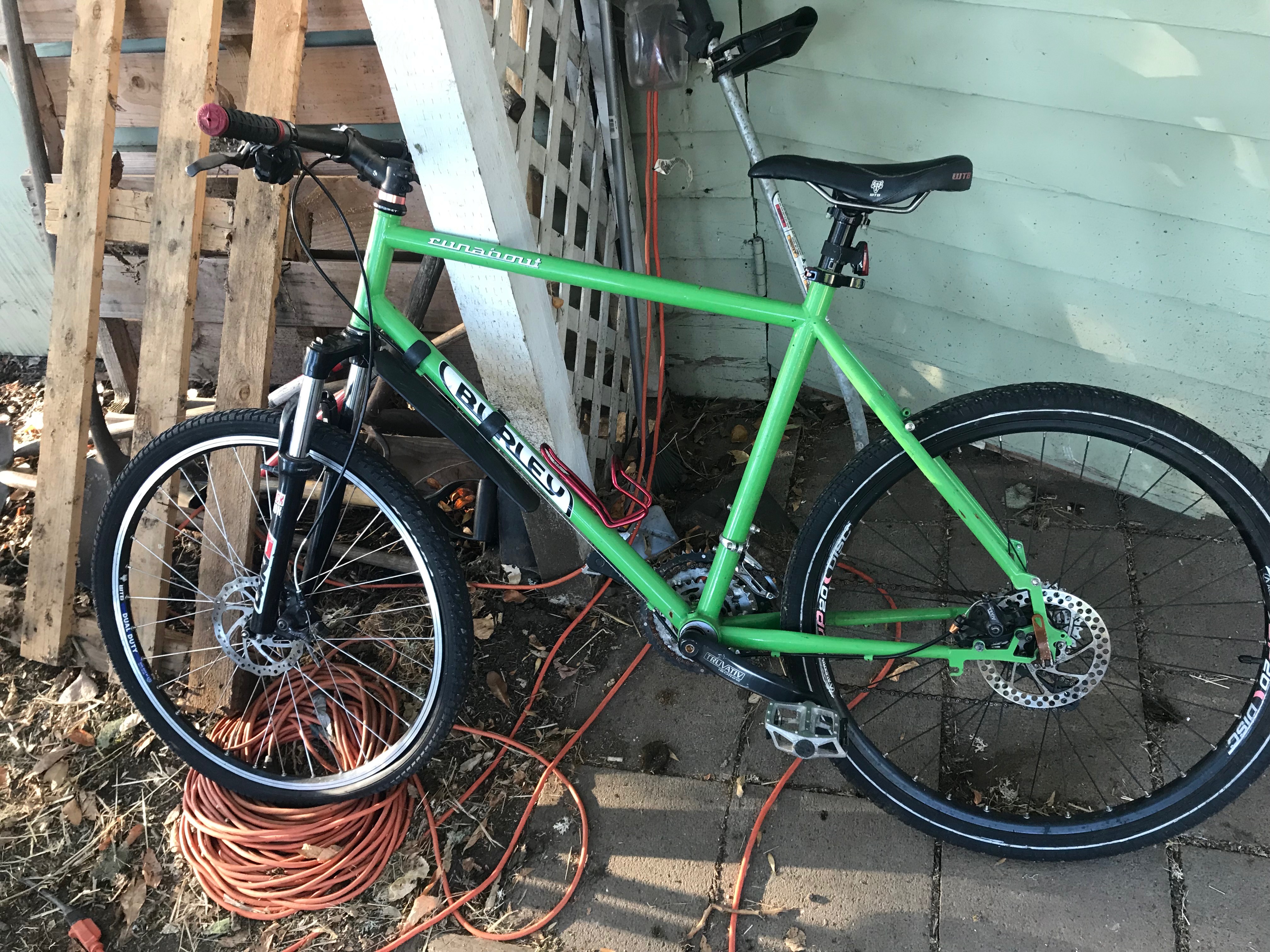

Been a while since I last posted as I waited for parts to get in, but have the bike and motor (still waiting on battery) and have a question about torque arm suitability as I start to put it all together.
Ended up getting the Burly Roundabout on Craigslist I thought I missed out on (seller was out of town). A bit spendier than I was originally planning, but it's a vintage steel frame handmade in my hometown and with nice flat e-bike friendly dropouts. Once I got the seatube unsiezed (lots of sweat and cursing) and trued the front wheel, it all seems to be in pretty good shape.
Motor is a 1000W 48V rear w/ LCD from ebay/APlusChoice (out of La Puente, CA, so pretty sure it's the same seller as yescomusa/xcerries, but APluschoice had the best price at $175). Still waiting on delivery of the 14S6P-PF triangle hardcase pack from em3ev.
For torque arms, the completely flat dropouts on the Burly give me tons of options. But, I unexpectedly took a 4yr kid in my house last week, and the amount of free time I have to craft something with just a drill, angle grinder and next to no metal working experience has shrank dramatically. The quickest/simplest option would be just sticking a 10mm wrench on the axle flats and then drill the end of the wrench to secure it to the pannier rack mounting bolt that the end of the wrench happens to line up with (or maybe just hose clamps). But, as you can see, the 10mm wrench doesn't have a whole lot of meat on it, and also has a bit of slop, allowing maybe 5 degrees of motion on the axle. There's probably know way to know for sure without trying it, but curious for people's thoughts: would one of these wrenches on each side likely do the trick? Or, does that look way underkill --in which case I'll try and find the time to work on something beefier out of steel plate while waiting on the battery (or maybe even--gasp--buy a pre-made torque arm)?
(note: the tabbed washers obivously aren't doing anything in their current location outside the wrench. I'd most likely remove them, or maybe put the wrench outside the washer and slightly bend the wrench handle in towards the frame to attach).
Play in a torque arm is a bad thing. It defeats the propose of keeping the axle in place. If you are going to go home made, try to make a clamping torque arm that you can tighten around the axle. Although steel dropouts are pretty good on their own. What I have been using for years are 3/8" x 4" U bolt plates. I have one on each side and I use 4 hose clamps to keep them in place. (two hose clamps per side.) Make sure you clamp the motor bolts tight. Less then $10.00 USA for the whole setup.

E-beach: got any pictures or more details you can share of your U-bolt torque arm setup? I tried searching your posts, but you're too helpful on here and there was a lot to try and sift through. The u-bolt plates I'm thinking of are fairly thin. I figured they'd flex a lot with two plates clamped around the axle and with bolts through the existing holes at the ends of the plates, so I'm wondering if I'm envisioning it correctly.
E-HP: Just measured it. The dropouts are 1/4" thick. The 10mm wrench looks pretty thin and puny in comparison (and in hindsight, probably provides little added benefit). Skipping the TA sure would simplify things as long as the dropouts can handle it (though I'd hate to be wrong).

At 10mm your steel dropouts may not need a torque arm.
My torque arm set wouldn't work for your setup. I run a front hub motor and have heated and bent my torque arms to fit my suspension forks. They also double as a washer inside the dropouts. And worst of all I can't find the pictures at the moment..... :oops:
My system would add about 6mm more steel total and help keep the wheel in place if the extreme event the dropout fails completely. . On my non axle side I just slide the plate onto the axle. On the wired side I took the wires out of my connectors and slid the cable through the plate hole so I could slide onto the axle. As stated I use them in place of the inner washers. Then I clamped them to my fork with hose clamps.
It may or may not work for you, but 3/8" x 4" u-bolt plates are cheap so playing around with it would cost you something like $2.00 USA. And if it works for you, it will help with the ghetto look that keeps thieves away.

My YESCOM, 1000w rear hub with 52V battery was fine with thick aluminum dropouts (Tidal Force frame) and no torque arm for three years until my son decided he wanted to construct a commuter/MTB with the bike and I moved the motor to a steel Schwinn; again no torque arm. Didn't consider regen since, for me, the downside is greater than upside.
I have a similar motor kit on my wife's bike with no problems so far. The LCD with your kit will be nice to see the speed and other data without a separate device. Without regen, I don't use a torque arm on her steel bike, and it hasn't widened the dropouts at all.

Thanks all. Picked some miscellaneous parts including a 4" x 3/8" U-bolt plate during lunch. Will experiment if I can do anything quick/simple for a bit off added assurance. If not, battery (with smart bms) will be here Friday :D and based on everyone;s advice I'll give it a try without the torque arm.
