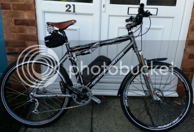

I finally got round to installing my new 48v Xiongda kit with the sine-wave controller. It'a a revelation compared with the first version. It's really smooth and quiet. I find the change-over from high to low and back again just about right. There's not much of a delay, and it changes so smoothly.
At 15A, it has slightly more torque and speed than my 36v one, which I ran at 20A. No-load speed with the battery fully charged is 37kph.
I got one of those Panasonic downtube batteries from BMSBattery. Together, they make the electrical installation very neat and easy. The light weight of the motor doesn't spoil the rear air suspension too much. The all-up weight is only 21kg, so the bike has very light precise handling. These motors are definitely the way forward if you want good climbing power, but not an electric motorcycle.

d8veh, that "Rocky Mountain" frame is awesome for a street commuter ebike. I just had a quick look at their website and the new ones have a smaller triangle. What year is it?
I think it's about 2008 or 2009. They turn up on Ebay from time to time.
BTW, to answer one of your previous questions, this new version of the motor with the sine-wave controller is a quantum leap in noise reduction. It is by far the quietest I have ever ridden - quieter than the DD motors I've tried.
