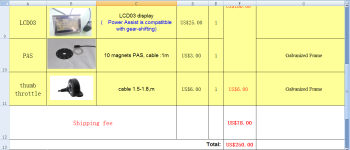

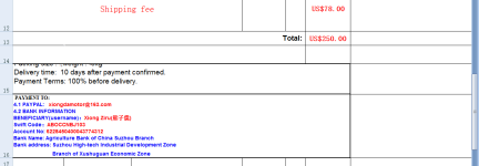

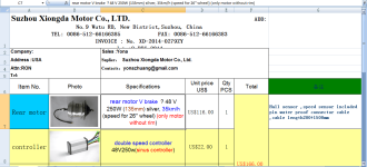

Monday I sent an email to...yona@xiongdamotor.com.cn...and I also sent an email in the alibaba (Chinese Ebay) inquiry window.
(later, on the invoice, there is also a contact email of: yonazhuang@gmail.com )
Today (Tuesday) she responded to both. They have two Kvs of motor. If using a 26-inch wheel, you can get 32 km/h on 36V or 35 km/h on 48V. I wanted to get the 36V motor (faster wind) and the 48V controller (controller must reverse on the fly, so I can't use my existing controllers) and I might have gotten 40 km/h (25-MPH), however...they definitely do NOT want to sell that to anyone. I suspect it may have to do with the clutches sticking. Since it is a bare motor (no spokes or rim) I might have asked for a 48V system for a 20-inch wheel (which I would lace to a 26-inch rim to get a higher speed than 35 km/h)
It appears the disc brake side-plate adds 10mm to the width, so drop-outs for a front motor a V-brake is 100mm, disc is 110mm. The rear would be 135mm for V-brake, 145mm for disc.
Then very soon after I responded she sent me an invoice to approve, and a paypal address to send the money to. It appears they don't have an option for selling a motor that is already laced to a rim (I'm sure this is why they have yet to be seen being used very often).

There probably are more winds available, but she sounded like she only wanted to sell me one or the other. I was hoping to get an answer as to how many choices there are as to Kv. I'm sure the average customer just wants to tell her what tire diameter and voltage they have, and Yona can provide top speed options (she only gave me two at this time).
I should have just ordered both a 36V and 48V 2-speed controllers (they are cheap), and one each of the two motors. I also wish the motors had model numbers, so when one ES member posted results, a reader can order the same exact thing without fear of a misunderstanding.
