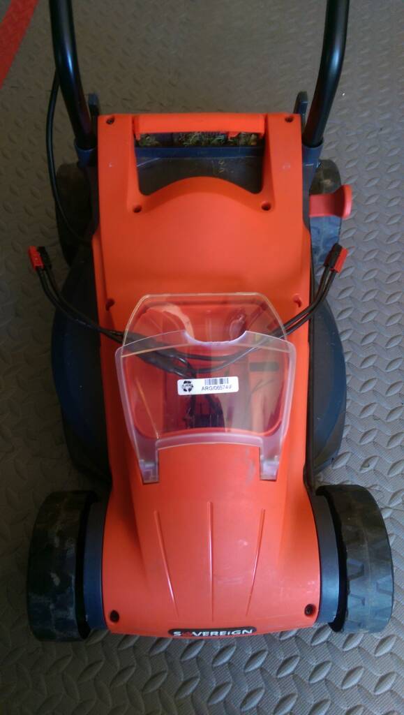

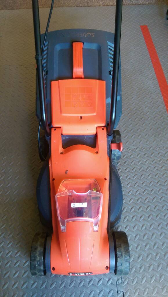

Thought I'd post some info regarding my LiPo conversion on a faulty 24v 4Ah Li-ion (BLDC motor) mower bought from eBay for £30.

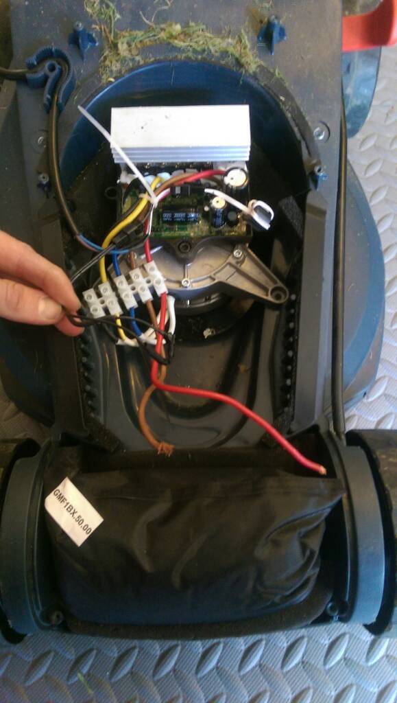

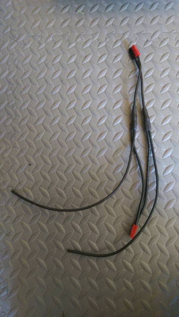

I added 6s2p LiPo at 12Ah. The only problem that I encountered was the fact that the old battery had 3 terminals: B+ B- and a thermistor connection.
Without the thermistor connected the motor will only start for 2 seconds and then cut out.
The thermistor is supplied with 5v via a pair of wires from the controller. The controller will be looking for a volt drop across these wires caused by the 10k resistance of the Thermistor at room temperature. It is a NTC thermistor so the resistance drops as the thermistor heats up and the motor will cut out (originally intended to monitor battery temperature).
In order to bypass the thermistor connection I simply connected a 10k resistor across the two wires and viola... Mower works perfectly and has more than enough capacity to mow my lawns
I understand that this is not the safest option and ideally I could have just purchased a 10k thermistor but I was being impatient!
I posted this info because I searched for quite some time online in order to find a solution and it would have been a godsend to find such a post on ES.
Such an easy conversion only took about an hours actual work!
