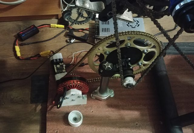

After playing about with reduction, it seems I can use this motor with pretty damn good efficiency (85% after all the reductions!) at 150 watts if I use *less* reduction and run it at about half of duty cycle.
That's a 115 kv copter motor rated for 3kw at 12s. 18 pole pairs, half kg weight.
Your chain setup looks good - if I can manage something like that I'd prefer it over belt because I get the idea the tension needed for good belt drive saps power.
What RPM and voltage are you getting your best efficiency at? I'm still interested in the relationship between theoretical freewheeling RPM (50% duty cycle * 12S * 3.7 V/cell * 115kv = 2553rpm?), loaded RPM and efficiency.
I'm still likely to go direct rear wheel drive because I just got some sprag bearings that could form a freewheel setup, and have access to a commercial mid drive ebike if/when I want it so direct drive would be a good comparison.
