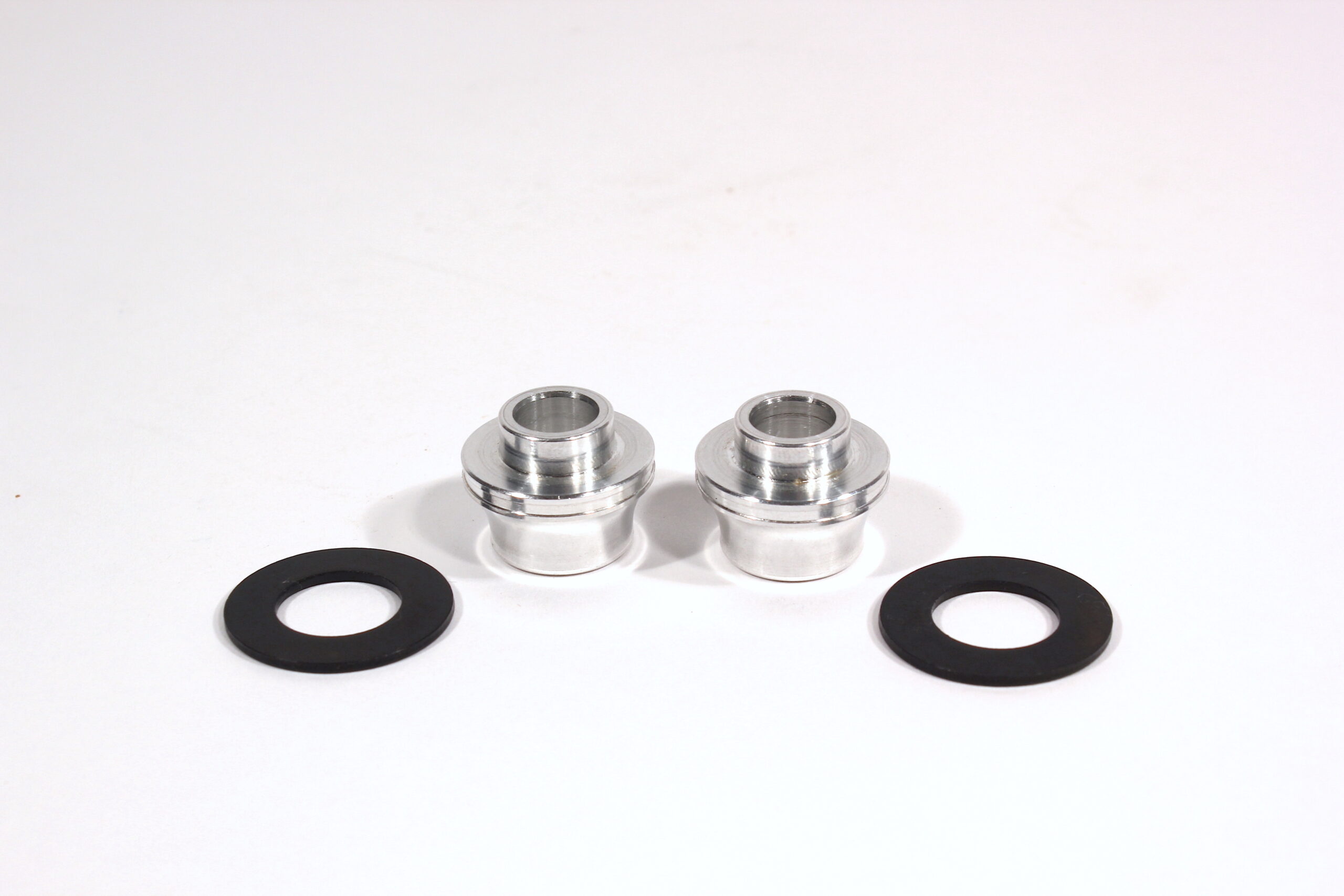

What about these?
Get a machinist to make you some beefy steel inserts to bolt onto the dropout and keep the power down, dont do jumps and look for another bicycle.
What about these?
That might actually work in addition to torque arms. I would personally consider running two torque arms on one side, 1 torque arm on the other, to make up for the fact that your axle isn't holding any of the torque itself.
I can't vouch 100% for that though.. let's see what others think
What about these?
Problem with any such stepped washer is it has a 3/8" or 10mm round hole, and your axle is 14x10mm. It won't fit.
If you get or make a custom torque arm, put the axle hole oriented vertically in the slot, to fully occupy its width.
Damnit, he right..
