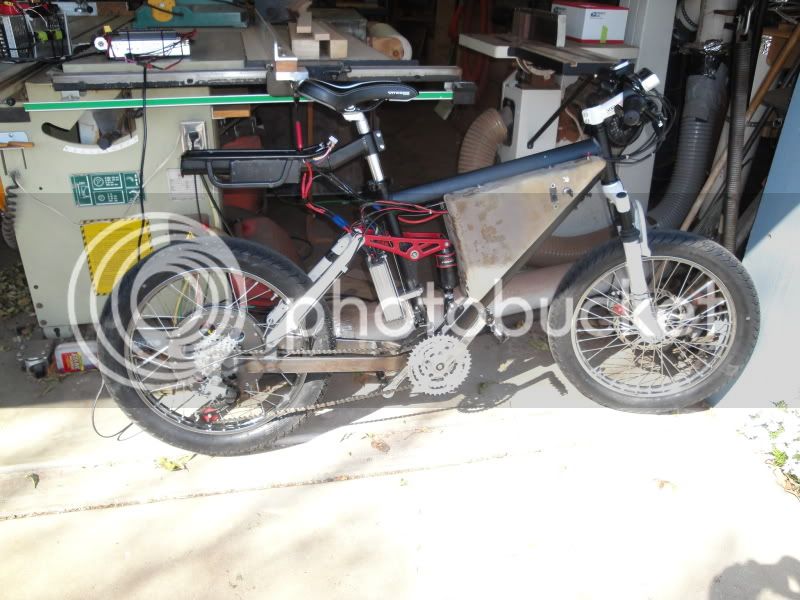

Who could look at this and not think that it just oozes bad ass?
Ok - I was going to make some funnies.. but this is a serious issue.
A 20" wheel is the only way to roll for straight acceleration... BUT there are two major problems with that. First the damn pedals slap the ground and second it just looks horrible. Horrible. Horrible.
Normally I don't care about aesthetics but some times I have to look cool so I can sell more stuff.
What is a guy supposed to do?
That is about the stupidest looking bike I could ever imagine. Even though I know it is about to be 15hp it is just ugly ugly ugly.
Maybe I can drop the front wheel from 26" down to 20" and it wont be so bad.
I love me my rear suspension so dont even think about suggesting that I get a pink BMX bike.

Methods, read to near the end of my peak power thread..
145mm sinz cranks, 2.75" tall pirelli tire in back, and 24 inch wheel in the front was absolute perfection.
( picture to the right is with a 24" wheel. )
Minus the giant 60t crank, you could actually get your bike looking decent this way, if it matters enough to you.
I can't help you with the looks, but a longer shock would raise the rear ride height and get the pedals back up a bit.
It does look, umm... funny. Not in a good way.
Here is a bike I built for my wife years ago, that has a 20" wheel in back and a 26" wheel in front. I think it's pretty nice looking, though it wouldn't suit your project requirements.
Chalo
I have been a fan of a 17" rear with a 24" bicycle front, although the weight balance gets upset a bit. I would imagine a 17" rear and 19" front is good for a bit heavier but balanced setup.

I have been sitting here trying to figure out if it is pride that is making me embarrassed by what the bike looks like. 99% of the time I dont care about stuff like that... in fact I often revel in looking "stupid". I think what is bothering me this time is the impression it will leave on people. Even if I accelerate at like 4G's all folks will think when they see it is
"ebikes sure look funny".
In a sense when I go out I want to change peoples minds. I am actively trying to change how people feel about ebikes. I want them to think they are bad ass and I want to crush the imagine that they are slow, heavy, awkward, pieces of shit.
I will try some different combos when I get back to my stash of wheels in the hills.
-methods
20" front wheel. Longer shock end-to-end distance to raise the back to avoid pedal strikes. Strap the front fork down a few inches to take out a lot of the pogo-action and not make the 20" front seem so tiny.

Your real problem with the 20" isn't the look. It's put your already too high and rearward CG even further rearward. Gotta extend that wheelbase to keep the front end down now that you have some respectable power.
Oh and a 20" doesn't have to look bad. Mine has a fat 20 in front that's just over 21", and the rear is just over 19". At well over 5" wide that rear tire is badass in person. Of course, I'm a bit prejudice. I haven't been able to get a good angle that captures the bike well though.

I've actually got that same frame on my wife's bike. I see what you mean... makes sense.
Only problem I have with the long 20" bikes is they pretty much lose the off road capability. (at least the real lumpy stuff)
I guess that is the price to pay.
