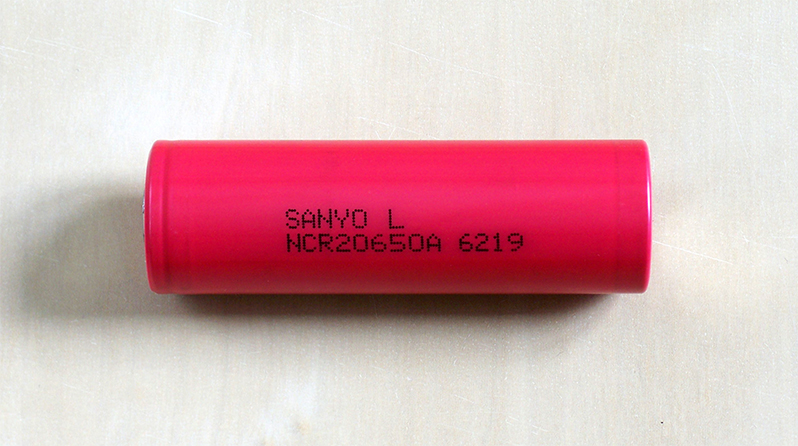

Sanyo NCR20650A
This cell's marking is SANYO L NCR20650A 6219. The letter L means that it was made in Japan by Sanyo Energy Higashiura Co. Here is its datasheet.
The main specs:
Rated capacity: 2900mAh (at 20°C)
Capacity (min): 2950mAh (at 25°C)
Capacity (typical): 3100mAh (at 25°C)
Discharge cut-off voltage: 2.5V
Max continuous discharge current: 30A (suggested, not mentioned directly in the datasheet)
Standard charging current: 2065mA
Max charging current: 6A
Charge end voltage: 4.20V
Max continuous discharge current and 0.2C current in Amps are not specified in the datasheet, so i took the first as 30A based on the second page of the datasheet and the 0.2C current as 0.59A based on the minimum capacity of 2950mAh.
So let's take a look at the results:
Curves are without sudden falls but the capacity at 0.2C is just a bit higher than the minimum declared. At 20A it was almost 2800mAh, which is an impressive result.

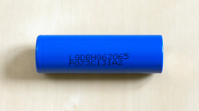

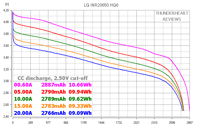

LG INR20650 HG6
I didn't find any official datasheet for this cell, but i found a couple of sites containing something very like a datasheet and i took the specs from there. The cell's marking is LGDBHG62065 P073C131A2.
The main specs:
Capacity (typical): 3000mAh
Capacity (min): 2900mAh
Discharge cut-off: 2.5V or 2.0V
Standard charging current: 1500mA
Max charging current: 4A
Charging end voltage: 4.20V
Discharge cut-off voltage is mentioned as 2.5V and 2.0V at the same time, so i don't know which one is the right one. I discharged down to 2.5V to not harm the cell.
The curves seem very nice to me, the results are very close to those of the Sanyo cell, the difference is miserable. I think 2766mAh at 20A is a brilliant result.

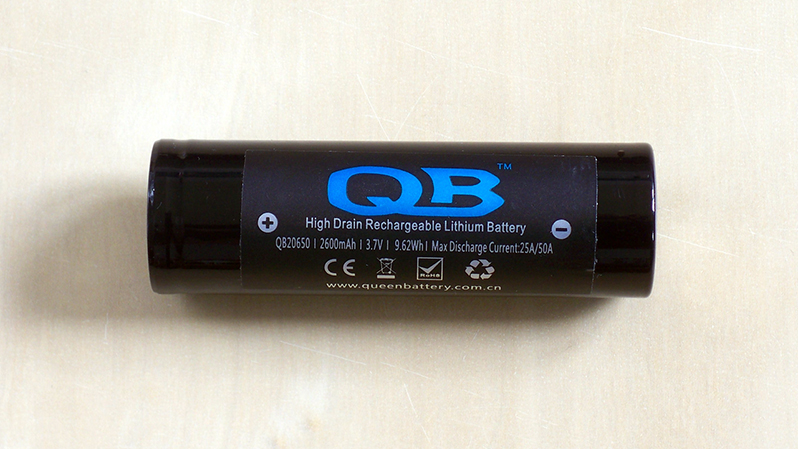

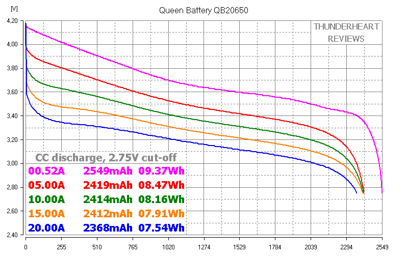

Queen Battery QB20650
The QB20650 is rated at 2600mAh, thus it doesn't play in the same division as Sanyo and LG. This cell has no marking on its heat shrink tube, but has a sticker with the most important information about the cell and a link to the Queen Battery's website. Here is its datasheet.
The main specs:
Capacity: 2600mAh (at 0.2C)
Discharge cut-off voltage: 2.75V
Max continuous discharge current: 25A
Standard charging current: 1300mA
Max charging current: 2.6A
The specs are nice except the discharge cut-off voltage. The 2.75V cut-off means that if you are going to add a protection PCB to this cell you will have to find a suitable one, because the majority of PCBs are set to 2.5 or even 2.4V. But let's look at the results:
At 0.2C (0.52A) it shows 2549mAh/9.37Wh - lower than declared, but at 20A it gave out 2368mAh/7.54Wh - a good result in my opinion.
CONCLUSION
Sanyo and LG showed very close results and both are great cells to buy. LG's results are just slightly lower than Sanyo's.Queen Battery QB20650 is from another division, so i can't compare it with two previous cells. It's a good cell but one should pay attention to its 2.75V discharge cut-off voltage.
