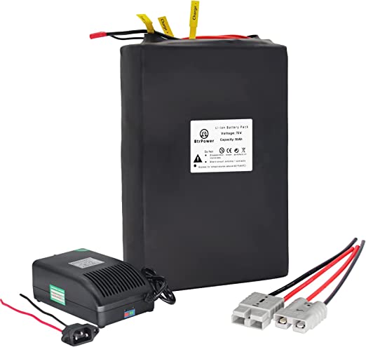

What about this 72V 50Ah Power-Plant that comes with only a 5A charger ...
https://www.amazon.com/Lithium-Battery-Li-ion-Electric-Bicycle/dp/B09QQCXX8T/ref=sr_1_13?crid=3H6P5XXVQR6RZ&keywords=72v%2Bebike%2Bbattery&qid=1650806564&s=sporting-goods&sprefix=72%2Csporting%2C137&sr=1-13&th=1
Is it mainly for safety and less expensive than a 10A charger OR maybe because of those Chinese "POLYMER CELLS". Don't lithium polymer cells have both a higher charge and discharge rate than lithium ion cells?
Is the following ad for this battery true ...
🔋【High Qulity】Top A grade POLYMER CELLS are more stable and less prone to explosion under severe impact, safer than the other cell.
