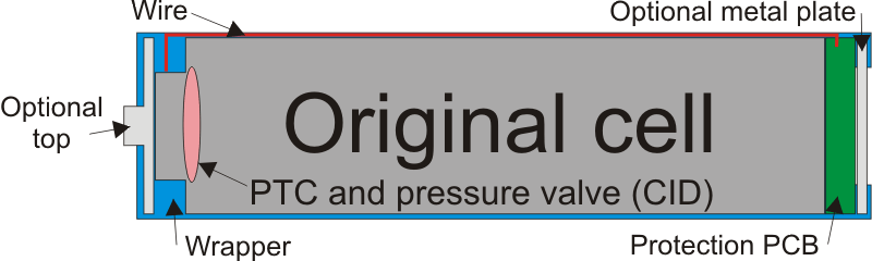

Proof that they use CID (Current Interrupt Device) is written at page 3 in this document: http://www.rc-electronic.com/downloads/pdf/infos/datasheet_LiIo_Panasonic.pdf
It works indirectly, high temperature increases the pressure inside, which blows off the connection and breaks the circuit. In essence, it is PTC with less resistance. CID is the correct technical term, not the PTC as I mistakenly called it many times before.
CID/PTC is visible at the top of the cell as a strange buldge. You can see when CID breaks the circuit in the panasonic pdf graph when things get wrong. PF is PD with safety layers added, not removed. That is the theme through the whole pdf they published. CID is moved to the top of the cell.
file.php

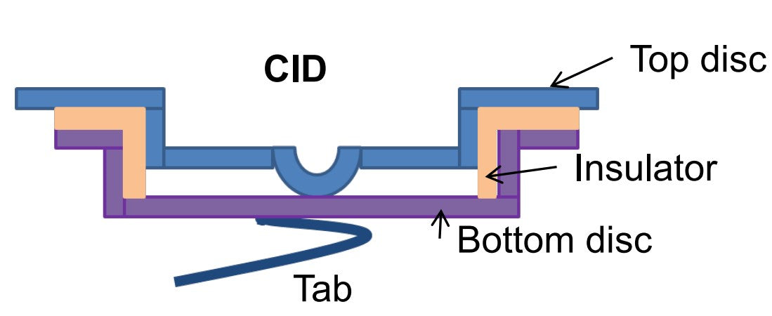

CID explained: http://batterybro.com/blogs/18650-wholesale-battery-reviews/18306003-battery-safety-101-anatomy-ptc-vs-pcb-vs-cid
It says "Collocated (placed side by side) with the PTC" in the link above. The very same document states that "18650 batteries sold in the US are required to have CID and PTC protection. " I'm sure that the rest of the world (or EU at least) mandates the same.
CID is the reason why I always use cells in series. Cell1+Cell2+Cell3+...+Cell13. If one of 13 CID blows, all 13 cells in 48V battery are safe. CID can fail 12 times without any consequences, one sucessfull CID is enough to protect the whole string. I even recommend fuselinks between the cells, just because we can :mrgreen:

Ahhhh now i see where we are confused.
The PTC and CID are two different things. They are not related.
None of these cells have a PTC. They reduce performance, because it's a temperature sensitive resistor in series with the cell.
The CID is basically an internal pressure tripped fuse.
When the cell is extremely hot and pressure rises (electrolyte boiling) the CID [strike]will[/strike] can cut off the cell, permanently disabling it.
I have tested several PF's and had them over 50C many times.....
If you overcharge a cell, it will also release gasses and trip the CID, not related to temperature.
I have not tested if a Model S cell has a removed CID. I guess I could overcharge and find out.
Another distinction, PTC's are always there and don't disable the cell. A tripped CID and the cell is trash.
