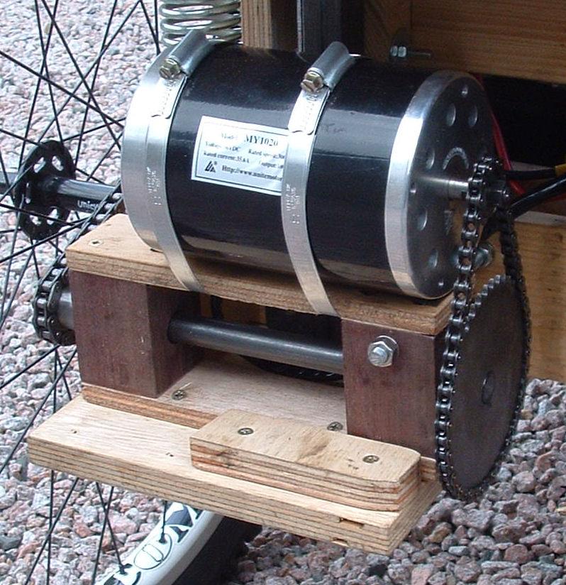

It's pretty simple, all you need is a two stage reduction gearbox.
You can make one easily.
I made something similar like this for a kids ATV.
