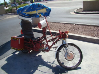

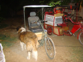

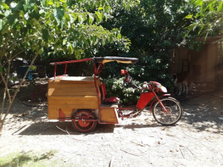

Yes, and no....for me: yes, I don't want anything like a giant metal cage...but, I regularly need to haul myself and big cargo (some of it wiggly), so my "SUV" trike the SB Cruiser makes sense for me. :)
My "SUV" bike, Crazybike2, also made sense (and it's replacement / successor that probably won't happen, the Cloudwalker Cargo Bike) for the same reasons.
Others have their own reasons for needing a bicycle or ebike version of an SUV; way bigger / more powerful than regular bikes or ebikes, but far far smaller than even a typical small car.

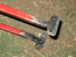

(I've seen a lot of broken racks "rated" for way more than the weight actually put on them, because that rating was either made up or was tested only with a static vertical load...so I ended up building my own racks instead, that I could be certain wouldn't fail under any loading I would ever put them thru (which is...saying something, given the crap I've carried. ;) ) Then I started building my own bikes/trikes/trailers because I was breaking them, too....
So true with these commercially available bike racks for their rear. They always look so good with those fat looking aluminum structural members, but they're actually more like soda straws and not really designed by an engineer. On a suspension mountain bike, I was using one of the racks that clamp onto the seat post to hold my battery and Those things are a joke. I finally ended up finding a 100% steel one and those are okay Aluminum just isn't right for all these tasks.

Some links inline below. Feel free to ask any questions here or in those threads. :)
They're all built "from scratch", meaning using whatever junk and junk bike parts I had, and heavily modified over time based on results, failures, experiments, ideas, etc., until they did what I wanted.
For your purposes, the SB Cruiser is the only one I've actually built that I think could do it, with some modifications to the keel structure / rear-front interconnect. (which I haven't done because they'd be in my way, but are actually needed even for my usage). SBC can carry, in the cargo area, about 400lbs, plus my almost-200 on the seat in front of it. It can haul much more than that on a trailer (upright piano was probably the heaviest single thing so far), but that doesn't do you much good. ;)
To do what you need it to, it needs to handle that on the seat itself, which I know the present keel design couldn't do. It would need a triangulated framework that feeds the loads from the keel into the rear frame, to handle both lateral and vertical bump and steer loading. A really good suspension would help a lot with that; I don't have suspension because it's too hard to come up with a good one I can build out of what I have that can be adjusted for the wide range of loading it would see (The front loading doesn't vary much on my usage, and I used to have a cheap susp fork but broke it in the only crash I've had with SBC so it's all unsuspended now). If your usage only really needs to carry you, then the load doesn't vary much and you can use a much more typical suspension design for the rear, and the front would work more like a regular suspension as well.
There's a MkII version I've worked out some ideas for, which will be adapted as much as possilbe using a customized versino of an ancient Schwinn trike here. I think that the larger-rear-wheel versions in these threads are a significant improvement over the small-wheel existing SBC, and the old Crazybike2.
CrazyBike2 evolved into something you might be able to adapt, as it became structurally stiff enough in the last version (would have had some further design work as the Cloudwalker Cargo Bike). Same suspension issues--you'd probably need it (I did too, but only had it in the front, same reasons as SBC). CB2 was, before SBC, my most-successful and most-used design. Like everything, it evolved thru breakage and failure into that. ;) I'd guess that including my own weight, it could do maybe 300lbs on the back but 200 was the max I'd regularly carry back there; just not room for all that much (it used trailers for more); that was a significant part of why SBC got built, to give a bigger single-area cargo space. Doesn't seem to be that much a factor for your usage.

The Raine Trike was a side-build for my brother, but I don't know how well it would have worked because he never used it beyond the test rides.
There are other builds but none of them would do what you need; they're just "regular bikes" except for Delta Tripper, which was the failed precursor to SB Cruiser.

To have broken racks rated higher than what was on them when they broke is insane. I would be so upset
Well, I never had anything new so there wasn't a warranty to worry about. :lol: I've discovered that virtually zero companies are interested in feedback to improve their products, so I don't bother doing that anymore. (might have back when I first broke racks if they'd been under some sort of warranty, but...).
Remember that any rating you see is almost certainly a static-load rating. So you can break things by using something well within that rating but applying a g-force to it that cuases the weight to far exceed that...but you didn't exceed the actual (static) rating. If there's no separate rating specifying
then there's the wiggle-rating, meaning what a rack would actually survive even without bumps if you wiggle it back and forth thousands of times...as will happen when you pedal, with every stroke. the farther to the rear the load is, the worse this problem is. The less-competently-designed the mounting and support framework is, the more likely it is that this will be a lower number of cycles.
EDIT: here's a link to the rack I built for a friend for his solid-tire bike that would really have beat up a regular one; it wasnt' finished yet and is just on one of my bikes to test the general fit before fully welding it up; i had ot wait till i had his bike to make the seatstay mounts. but it was "bulletproof". If I were to rate it like most ocmpanies do, i'd call it good for a hundred pounds or more. :lol: If it were made ot of good chromoly instead of crappy ex-retail-signage-fixtures, i'd double that.
