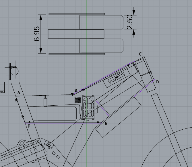

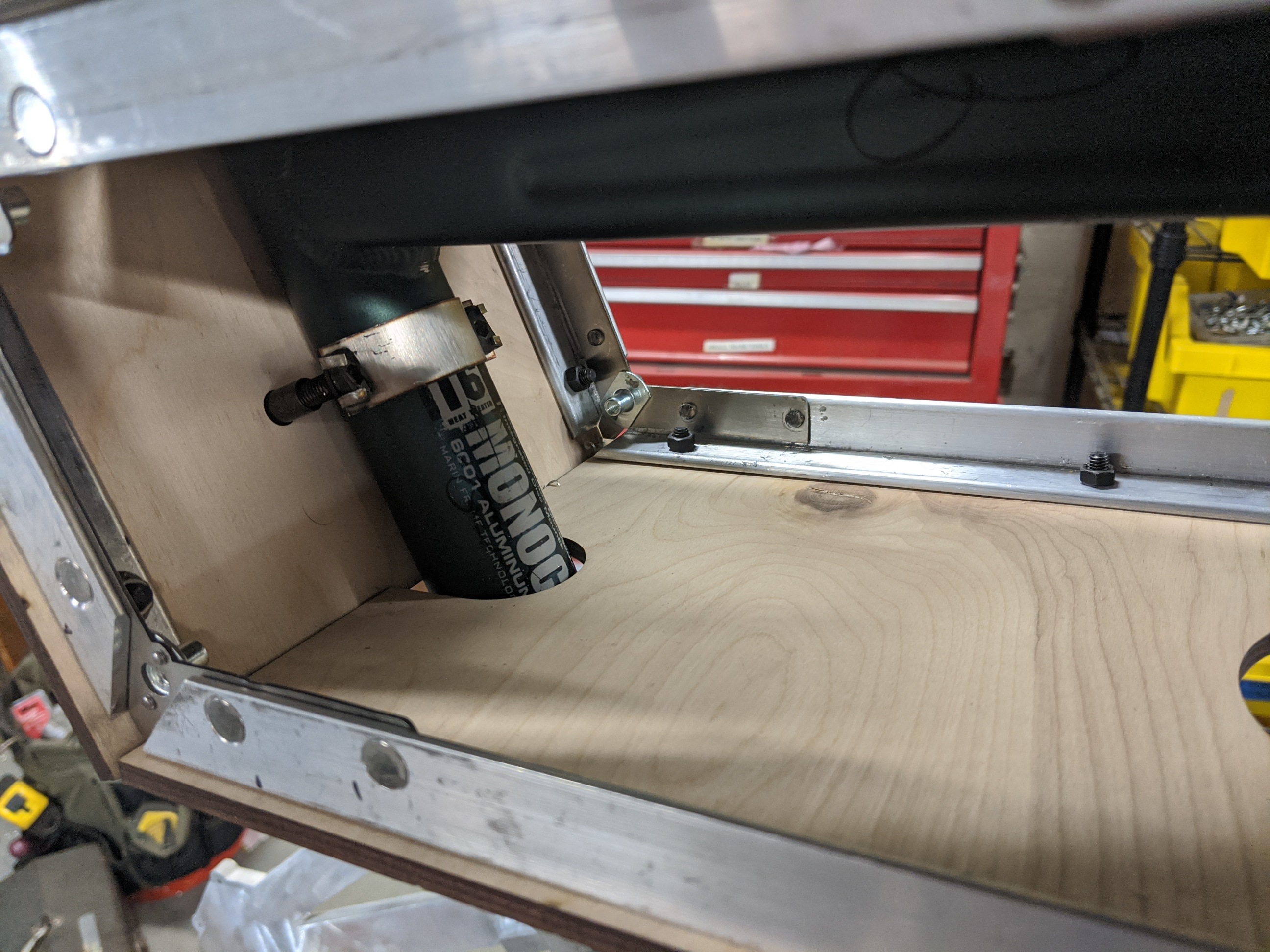

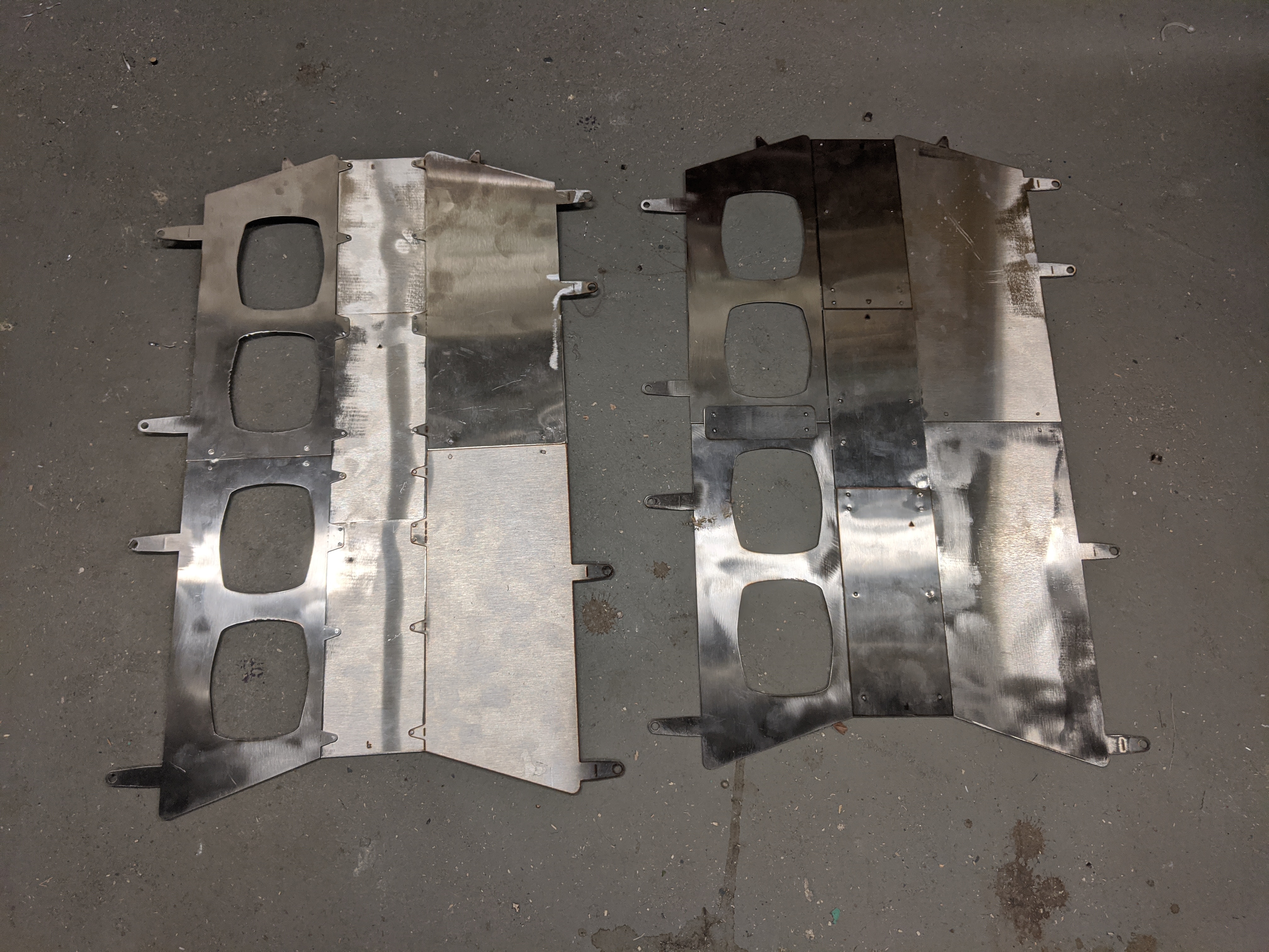

The final build is probably going to mount everything along the top tube of the Fat Bear, so I'm prototyping a box that will be in the same position as a motorcycle gas tank. These are laser cut stainless steel flats to build the battery box.
The steel portion of the battery box, folded:
The battery box involves a combination of laser cut stainless steel and wood. Here's a test fit on the bike:
