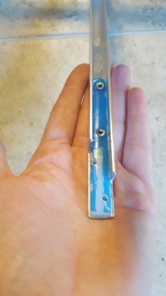

Just FYI - that rack is going to fail quickly. If you can't sit on it with 180ish pounds while it's not moving, it won't stand up to 10-20 pounds while dealing with potholes and curbs.
If you do need to redo the rack, to prevent side to side wiggle and whatnot that can fracture the aluminum, you can look at this rack I built here:
The weak points are the front struts, which are attached by aluminum rivets. I can add another rivet on each side to strengthen it. I also used JB weld on the inside to strengthen the four corners of the top, and can add some of that to the struts. When I took the wheels apart, I realized that the rims are pretty weak -- single-wall aluminum and daylight visible through the seam. So if I come to a curb or unavoidable pothole, I'll stop and walk it over. So the rack will not get a lot of stress.

Unfortunately even a welded rack of the shape yours is will still wiggle side to side with a load on it as you pedal, or lean the bike, etc. That's the main problem, and is what fatigues the struts and the points where it connects to the bike frame. That's where most racks break. (Iv'e broken more than my fair share over the decades).
Any rack design that can't wiggle side to side will survive longer than one that can.
They don't usually move in other directions, but if the vertical supports can bow outward (or inward, etc) then there can be fatigue from that, too, and if the bowing allows a load to continue pushing down during an impact, for instance, it can bow it out permanently or even collapse (steel or aluminum).
But usually it's the dropout rack supports that fail, right there at teh dropout.

Update on the build, specifically the rack. Several people here mentioned that racks like mine have a tendency to fail at the joint where it is attached near the hub. The idea is that weight on the top torques the rack from side to side, leading to metal fatigue and eventual failure at the point of attachment. So I made two modifications. One is the addition of triangles to reduce side-to-side movement. This is the same general principle used by amberwolf, although because I'm retrofitting, mine is not as sturdy. The other is the addition of cross-linked polyethylene (PEX) strips across the part that is susceptible to failure. The idea is that the additional layer makes that part stronger, and also if the aluminum does break, there is a flexible piece that will not -- kinda like fiberglass, where there is a combination of flexibility and rigidity. PEX is used for water lines, as it can expand without breaking if the water inside freezes. I have a lot left over from plumbing a house I'm working on. I cut strips from the largest diameter I had (3/4"). It's still a bit curved, but not so much that it won't work.
Added triangles:
PEX inside the U-channel, with rivets to attach, and holes to attach to bike
Reverse side of U-channel where PEX is attached:
On the bike:
amberwolf said:
That will probalby help, if it doesn't fix it entirely. :)
Should be interesting to see the results over time.
I hope so. It certainly feels a lot more durable. I'll try to remember to update either way.

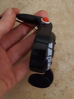

My latest:
I didn't want to use one of the standard brake-lever-style motor cut-outs. I'm adding a front caliper brake, and I will have a lever for that. But I decided that it was a good idea to have some sort of motor cut-out, as the PAS continues to run the motor a few seconds after pedaling stops. So I bought a small button that shorts when pressed, and drilled a hole for it on my thumb throttle. I will have to turn the throttle off from the controller when I'm in France, but I can leave it attached to the bike. So if I want to cut the motor, I just press the red button.
The button:
The thumb throttle:
My melding of the two:

Yeah, my controller has both brake options -- the three wire one that is powered, and the two-wire one that just shorts. I was going for cheap, as my throttle was ~$3 and the button about a dollar. But I like the idea of engineering the cut-off onto the regular brake. I might try to build something when the brake handle arrives.
